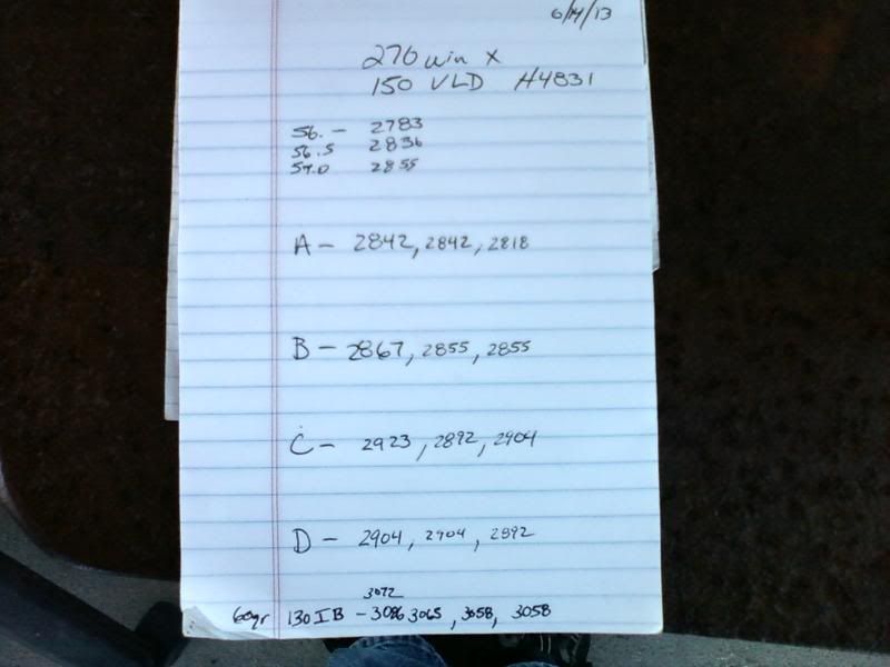

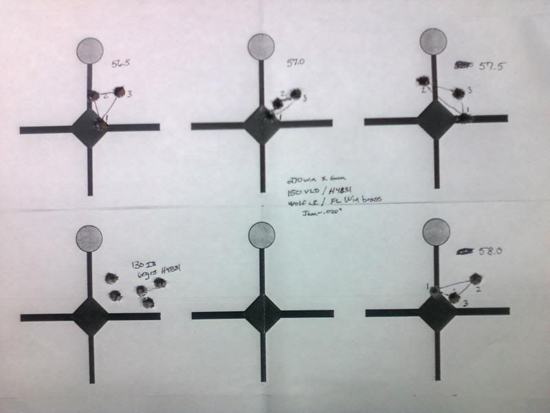

My turn. Here's a target shot with my 270 win using 150 VLD hunting. Using H4831, Winchester brass, wolf LR primer. Don't pay attention to 130 IB load.
Load left to right: A-56.5gr, B-57.0, C-57.5, and D-58.0 grs. Loaded jam -.020"
Looks like 57.0 grs to me as center

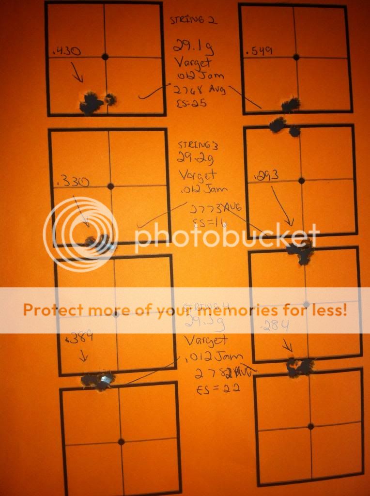

Loaded up some varget 29.1, 29.2, and 29.3 and shot 2 5 shot groups with each over my chrono.
Chrono Data: note for right side groups. weather finally agreed with the chrono.
String 2
1) 2784.0
2) 2763.0
3) 2759.0
4) 2765.0
5) 2769.0
High: 2784.0
Low: 2759.0
E.S.: 25.0
Ave.: 2768.0
S.D.: 8.6
String 3
1) 2775.0
2) 2781.0
3) 2773.0
4) 2765.0
5) 2771.0
High: 2781.0
Low: 2765.0
E.S.: 16.0
Ave.: 2773.0
S.D.: 5.2
String 4
1) 2793.0
2) 2771.0
3) 2780.0
4) 2781.0
5) 2783.0
High: 2793.0
Low: 2771.0
E.S.: 22.0
Ave.: 2781.6
S.D.: 7.0
Thoughts?
good shooting there. 29.3 appears to hit lower.
These all appear to be same place vertically, although a bit erratic. Adjust seating depth on 57.0 gr load and see how good it gets, if not satisfied, run test again using best seating depth. Good luck.

Thoughts?
Interesting - to my eye the test stopped a little short...maybe previous testing had shown above 29.3 there was pressure. I would be interested in 29.4 and if possible a 29.5...the expectation is that they would change POI slightly and start to open up again, putting 29.3 at the best place.
In part I say this because both 29.3 groups hit at the same POI...the others all had some measure of POI variation between them, but the right hand 29.2 group is sitting very close to the same POI as 29.3 and both 29.2 groups were well formed.
If 29.4 showed pressure then 29.2 it is...but I have always found it hard not to pick the middle group when using 3 groups for comparison under this criteria.

If you look back a few pages youll see that this was shot after a load testing from 28.1 to 33.6 and then playing with seating depth, just narrowing down closer to the end.
Sure - post was an observation rather than a criticism.
