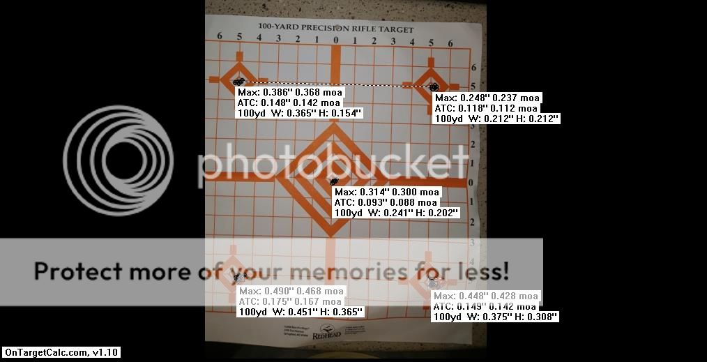

View attachment 1101460 Why not do both at the same time?
You're showing only a last portion of load development. That is, tweaking a chosen combination for best group shaping.
You're not showing the portions of development leading to that chosen load & land relationship [28-29gr, ITL].
As far as why not do seating and powder at the same time? It's because it's 2 changes at the same time, and would lead to a helluvalot of tail chasing with anything but a tiny/all known about 6PPC.
Imagine going right to the end(as you're implying) with something like a 260AI for distant shooting.
Full (actual) seating testing goes from ITL anywhere to .120 OTL.
Incremental powder testing for it spans 5 full grains.
Put that on a spreadsheet & consider remaining barrel life after firing so many shots.
If you plotted results of it out and posted on a big wall, you could sit in front of it and see the cosmos for what it is (chaos), and be no closer to finding best load.
You'd see big swirlies of SEATING, POWDER, CAPACITY, TENSION, BORE CHANGE, and CONDITIONS -at the same time..

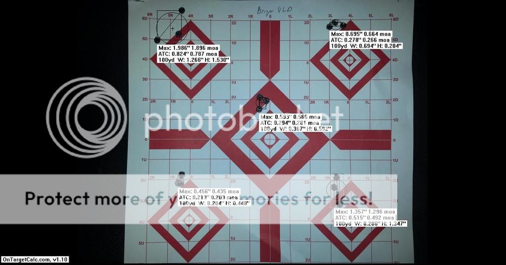

After getting mediocre results working up a 6BR load in a 28” CBI threaded to a SA 700 I’ve decided to try this route. The idea of finding the “best” group as a starting point based on seating depth removes a potential variable from muddying my already frustrated psyche.
Trouble with load development in a 6br?
Target below is a starting charge weight test with varget and berger 105 hybrids jammed 0.010. Starting load 29gr to 30.2 gr. Hard to pick a winner. With a little seating.adjustment and another load test wound up at 30gr .005 off.

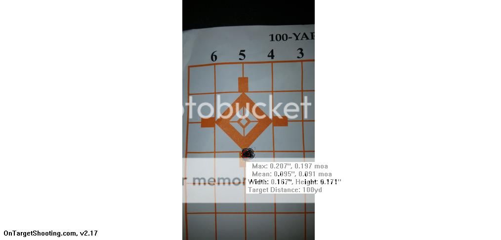

And the final result
http://[URL=http://s1056.photobucke...rcoody1/on target_zpsiohc9gxw.jpg[/IMG][/URL]
Nice test. To answer your question, because I want to establish what the maximum load is. Also, using my method I can discover or confirm the spacing between nodes and how many there are. What I described was an initial test of a new powder, using that information I would do further testing. I just want to know where the limits are. So often I see friends start to do detailed testing, stopping where the manual says to. In many cases individual rifles and lots of powder will safely exceed that charge weight by a significant amount. I presume that you have compared the manual top loads for the 6PPC with what many competitors actually use. That is my point. You can miss a lot by not knowing what your actual upper limit is.
29 gr of LT 32 is about the upper limit
I can tell this by the way the groups form at that load compared to 28 and 28.5 it spits one out
That's the good thing about having it all on one piece of paper a lot of information there
