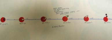

Here is my AIAE with Benchmark 6.5x47L barrel. Sierra 123 with Varget, 100 yards. last 2 groups the primer center started protruding but no blown primers, no other pressure signs, easy bolt lift. From what I have read the AI bolt tends to do this with small primers.
[br]
Primer extrusion as you describe is the result of a large firing pin hole. It is commonly corrected by bushing the bolt face and modifying or replacing the large diameter firing pin. I don't think I would do that with your AI bolt but is the most common approach. [br]
Sometimes, a hard cup primer like CCI 450 or Russian SRM (KVB-5.56M) will fix the problem. Worth noting is that these two primers are not reliable for detecting pressure.

Thank you for the info, that is what my research had told me. I might experiment with harder primers or just stay at the lower node, depending on component availability.

Here is my AIAE with Benchmark 6.5x47L barrel. Sierra 123 with Varget, 100 yards. last 2 groups the primer center started protruding but no blown primers, no other pressure signs, easy bolt lift. From what I have read the AI bolt tends to do this with small primers. I did chrono 1 round of some of the loads. These were the first 30 rounds through a brand new barrel, 8 rounds to sight in before starting this test. First group is 4 shots (cause it was stringing so bad I threw the last one in), the rest are 3.
What is your read?
Judging by your target, your rifle is very accurate, as most of the groups look good.
I would try 37.3 gr., since it's between 37.0 and 37.5, which both shot well. Also would be tempted to try 36.3 for the same reason, but I would try the faster node first. Good luck and post results after you do seating depth testing in .003" increments.

Erik, here are my 100yd. groups from this morning. It's a 6MM Dasher shooting 105 Berger Hybrids Molyed, with CCI-450 Primers, Lapua Brass. All bullets jumping .020. There are six groups starting at 31.0Gr's of H-4895 and going up in .3 Gr. increments and ending with 32.5Gr's of H-4895. Could you please tell me what node you would settle on as this is new to me. Thank

Chuckhunter, looks like 31.3 gr is in the middle of a node. But it also appears that 31.9 and 32.2 are another node. I would also try 32.0 gr to see how it does.
Work on 31.3 first and work on seating depth moving .003" at a time.
Erik, thanks for the quick response. I was also thinking along the same line. I will definitely try 32.0Gr's and I think I'm pretty close on seating depth, a few minor tweaks and I should be good to go. Thanks again.
I would load 31.3 and 32.0 at different seating depths as mentioned, but shoot you groups further out (300) if possible. Not going to be able to tell much if all your groups are in the .1's.

I would do like Erik suggested. 31.3 looks great. I would do a few seating depths and re-shoot 31.0, 31.3, and 31.6 gr. I would find the seating depth that has least vertical in the groups and make sure it is a node again. 31.3 looks perfect, but 31.0 and 31.6 has a good bit of vertical. If I had a rifle that shot this accurate, the above would be based on Tony B's method he describes in his book
Great shooting 8)
