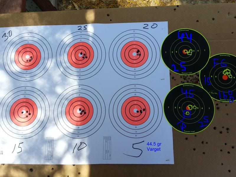

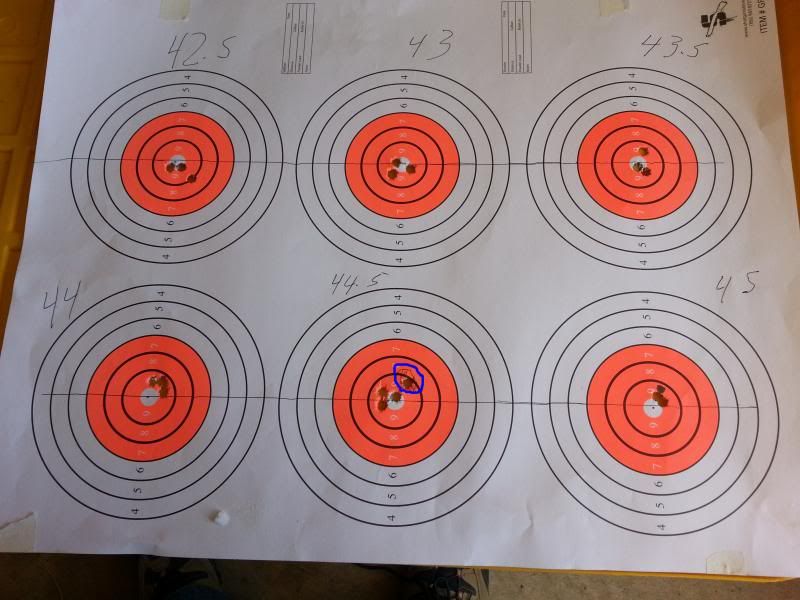

Went back out to do seating depth testing using the 44.5 gr of Varget load recommended by Eric. This was shot out doors as opposed to yesterday’s test which was indoors. The wind was pretty switchy today right to left and the results show this. The specs are Savage FT/R rifle that has been pillar bedded with the action and bolt trued. The barrel is a 30” Krieger. The load is Varget and 185 Juggernauts.
Here is yesterday’s target.
And heres todays. The shoot and Cs are yeasterdays best groups of 44 and 45 grs of Varget the blue circle is a pulled shot. The other shoot and C is my foulers which is FGMM 168 with about 15 rounds!
What do you guys think?
thx Ted

savageshooter86 said:
appears 48 with Pro 2000 is your node. The previous load using Varget @ 44.5 I would say target labeled 20 is your load.

I was at the range shooting with Ted today. The winds were pretty frisky when he was running the Varget strings. Given the wind vectors that my flag showed, either 5 or 20 are candidates. [br]
South Bay Rod and Gun Club is, at times, a very frustrating range. Today, there were numerous dust devils, winds going all around the clock (quickly), and significant vertical when there is a head or tail wind. We had both today. :(

You said you used the FGMM for your sighters??? I'm not sure what powder they use and it could be scewing your data. If that powder is not comparable to Varget it would throw your first couple shots off until the Varget laid down enough powder in the bore to settle down. I always use the same powder for foulers to eliminate this question.
