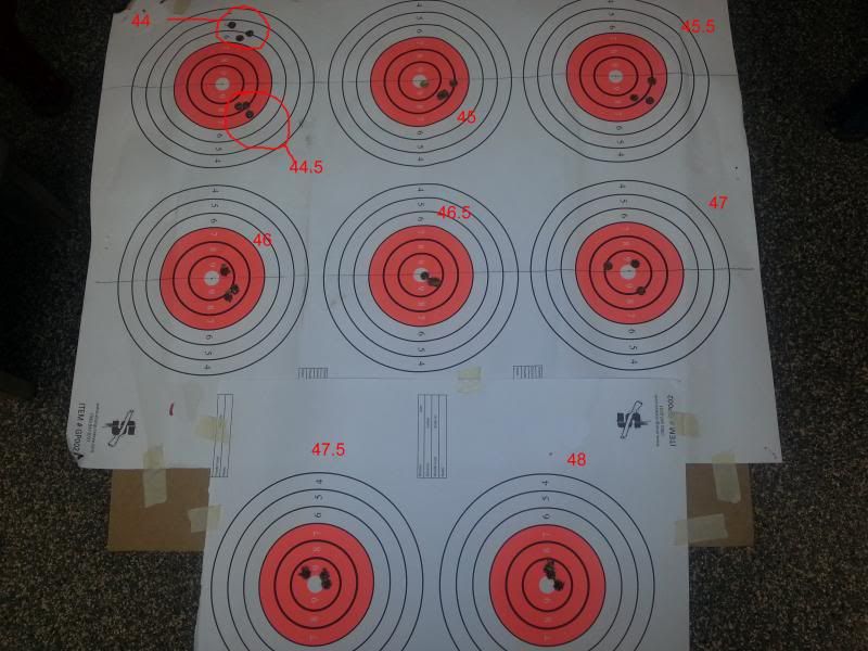

I got out today to shoot a second round of load development. The rifle is a Savage F/TR 30" factory barrel, Hornady 178gr BTHP and Alliant Pro MR 2000 powder.
Here is Day one results with loads from 44-48 grs

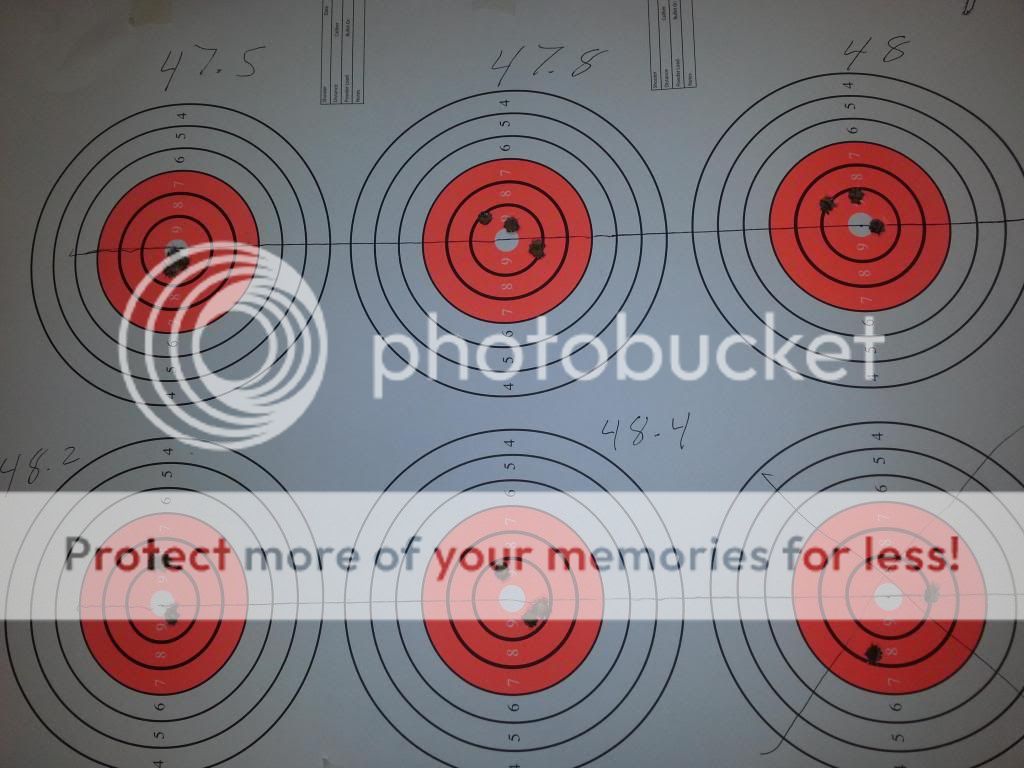

Here is todays results, what do you make of it? It's all still a little confusing to me?

47.5 looks good, but 47.8 scares me.
I would take 47.8 and play with seating depth, when you get it shooting, try the same seating depth on 47.0 amd 47.5 and see if theh shoot, if they do, go with 47.5 and you'll be done. I hope I made sense. ;)
Erik for my understanding, doesn't the second target show 47.5 low and 47.8 just above center line, and 48 even higher above center?
And on first target 47 hits lower than 47.5 and 48?
Just wanting an idea odd how to assess the data
Yes they do, but sometimes if things aren't just right, seating depth will make things clearer. That's why I suggested he change seating depth and try again. I should be clearer for good or bad after that.

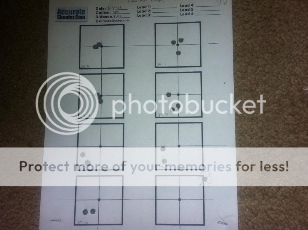

Target shot with 6br varget powder 28.8-30.6 what do you think?
Ignore the one circled and x out shot as it was accident.
scalian,
Please understand my guess would be 28.9, 29.1, and 29.4. Pick 29.1 grs. Wonder why 29.1 shot a little different. Lets see what Erik says.
Then again is looks like 30.0, 30.3,and 30.6 looks pretty good too. with 30.3gr as center.

I would go with 29.1 and adjust seating depth. It should have shot better since the groups on each side of it are good.
