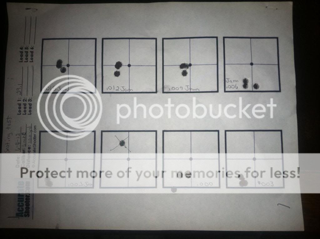

Here is a target at 29.1g varget with seating depth from .015 jam to .003 out of the lands. My thought is that .012 jam puts me in the middle of three good groups leaving some margin for error.
Thoughts?
Thoughts?
Yes, .012" is what I wold go with. Now you can take that seating depth and shoot groups every .1 gr. and try to bring it in even more. It seems like you are there, but see if you can tighten it up even more. Nice shooting!
I would go with 003 jam. With that charge and seating depth it gave you the best group. I never heard of doing a seating depth test the same as working up load weights as far as finding 3 close together and using the middle one? ???
Unless you are not confident your set up will produce consistent OAL(base to ogive) loaded rounds
This is where people get in trouble. They go with the smallest group that will be inconsistent instead of going with a little bigger group that will agg and be consistent. Do you know how fast you will erode .003" in a match such as F-Class Nationals? Guys that go with the .003" jam are the ones cursing their guns at the end of the day.
What Erik wrote is correct. I always validate a potential load choice by shooting five 5-shot groups, over my chronograph, at match cadence. If all five groups do not meet my criteria, I determine the cause and fix it or continue development. I'm taking about 550 rounds to Raton this August. It's certainly worth the effort to make sure it is the best load.
Ok so for seating depth once you find the node, we should be doing the same process with seating depth? Shoot groups and find the groups that hit same POI vertically and chose the middle seating depth?
Just suppose his smallest group was 012 jam, and it shot 0.2 MOA. Then seating depths of 006,003, and touch shot larger groups 0.35 MOA, but hit vertically same. Wouldn't the 012 seating depth Agg better since it shoots the smallest group with that powder charge?(Assuming these loads were verified on another range session like sleepygator wrote
There's nothing that says you can't get lucky and hit the right setting immediately. It's a question of assuring that you have a tolerant load. If your seating depth varies ±.001" and leade position increases .002" over a two day tournament, the load is potentially .003" from optimal seating depth. By loading the middle of the range, changes like this are tolerated better. [br]
While I've successfully shot jammed loads, I always found them more sensitive that jumped loads. Since the advent of Berger Hybrids, I no longer attempt to find jammed loads.
Savagaeshooter, we don't need any what if's. Simply take the 3 groups that are the same place vertically and average the group size, then take the small group you like and average it with the groups on each side of it and you will have your answer on which would agg better.
Erik and Steve thanks for the info.
The 003 jam and the 000 and 003 jump seem to hit same POI, just low on the target vs the others. But 000 appears to scatter. So I guess that too shows some potential issue like Steve said if you get some erosion during a long match with a lot of rounds fired.
I agree that the .003" jam, 0, and .003" jump have potential, however, I don't ever recommend being at 0 due to bullet inconsistencies some will touch and some will jump, therefore giving you problems. I would keep jumping further to see how I does. Try .006, .009, .012, etc out to about .024", you might find a more accurate node.
