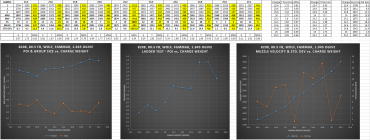

Long range load development at 100 yards.
80.5 / 8208 / 223 / .200 FB / seated 0.015 off / 40F. Targeting 24.2. All data comes from LabRADAR and Shotmarker fired @ 200 yd

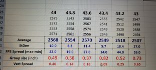

Today I FINALLY got around to shooting my powder charge fine tuning, just about 2months after loading them!
Anyway, just after opinions on the best pick. I have my thoughts, just keen on others. These are 4 shot groups.
FYI, Ignore the POI changes between the first 3 groups.
Thanks all.

Unfortunately you can’t ignore the POI changes that directly relates to the stability of the charge window. You’re looking for a window where the POI doesn’t shift versus the charge weight. Groups size are important but can be changed with seating depth or primers.
I would re-shoot and don’t adjust for POI. And note where the groups center land.
I liked the speed node (?) between 43.8 and 43.4 . I would shoot those 3 again ( 5 shots each ) and ck. the speed. I think you're close so scrunch down the rabbit hole a little further ( make sure the scale is calibrated, eliminate all possible inconsistencies , load all test cartridges in the same room on the same day with the same humidity, ck. for consistent brass, etc. ) But you know all this stuff.
Good luck with your project, JD
Yeah, me to. Going to load 43.4-43.8 in 0.1gr increases. Ive gone through seating depth testing and Im within a good node, so this should be a final test to lock in something. This is a factory Tikka T3 for sub 600yd hunting with some occasional fun on LR steel, so im happy where it is now, but its fun pushing for that lil bit more!!
take care it's a very deep rabbit hole JD

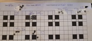

Lot of information here. Great thread. I tested this method the past two days Erik originally posted and curious what everyone thinks my final load should be. Top row is the powder charge ladder in .5 gr increments, middle section is seating depth test and bottom section is a fina powder test in .1gr increments to confirm after seating depth. Which charge at the bottom would you select for final load? All groups are 4 shot groups with my M40A5 in 308 except for the seating depth test in middle 175gr smk, varget and lapua brass. @Erik Cortina IMG_8870.jpeg
