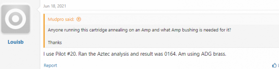

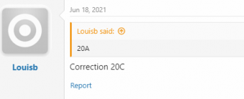

What pilot are you guys using for the AMP Annealer?
Thanks!
from post 197.
