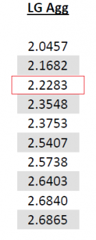

Just got back from the NBRSA 600/1000 Nationals. For 600 LG - I tried the 300 SI LG with Berger 185 juggernauts to see how it would compete against the 6mm's. There were some pre-match questions as to whether this was a wise choice since I did have a 6mm ready to go for LG. What the heck - wanted to give it a try :).
My 300 SI HV barrel is on my Wheeler built LG BAT B w/magnum bolt. Comes in right at 16 pounds 15oz.
I think it did ok (red) in terms of group agg against the 6mm's. Here are the top 10 600 Yard 6-target LG group aggs:

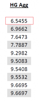

For 1000 - Shot the 300 SI HG (26+ pounds) with the same barrel that won HG at last year's Nats (with vintage [early 2000's ??] dimpled bottom JLK 210s).
Here are the top 10 1000 yard 6-target HG group aggs:
Just got back from the NBRSA 600/1000 Nationals. For 600 LG - I tried the 300 SI LG (16 pounds 14oz) with Berger 185s to see how it would compete against the 6mm's. I think it did ok (red) in terms of group agg against the 6mm's. Here are the top 10 LG group 6-target aggs:
For 1000 - Shot the 300 SI HG (26+ pounds) with vintage JLK 210s.
Here are the top 10 6-target aggs:

Just got back from the NBRSA 600/1000 Nationals. For 600 LG - I tried the 300 SI LG (16 pounds 14oz) with Berger 185 juggernauts to see how it would compete against the 6mm's. There were some pre-match questions as to whether this was a wise choice since I did have a 6mm ready to go for LG. What the heck - wanted to give it a try :).
For 1000 - Shot the 300 SI HG (26+ pounds) with the same barrel that won HG at last year's Nats (with vintage JLK 210s).
