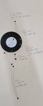

These are those 205ish ones Roy made up. It's the first try on my die with these jackets. I have enough jackets to actually finish tuning the rifle this time. Should be in the ballpark right away I hope, as it's the same barrel and powder I had going last year.

600yd ladder from this guy today. First ladder after fire forming. The first 5 were shot in a decent condition then the wind started. So the high node is likely better than in it may look. Even lost one shot off the paper. But the low node will do all this thing needs. One and done. Nice to not fight them.
