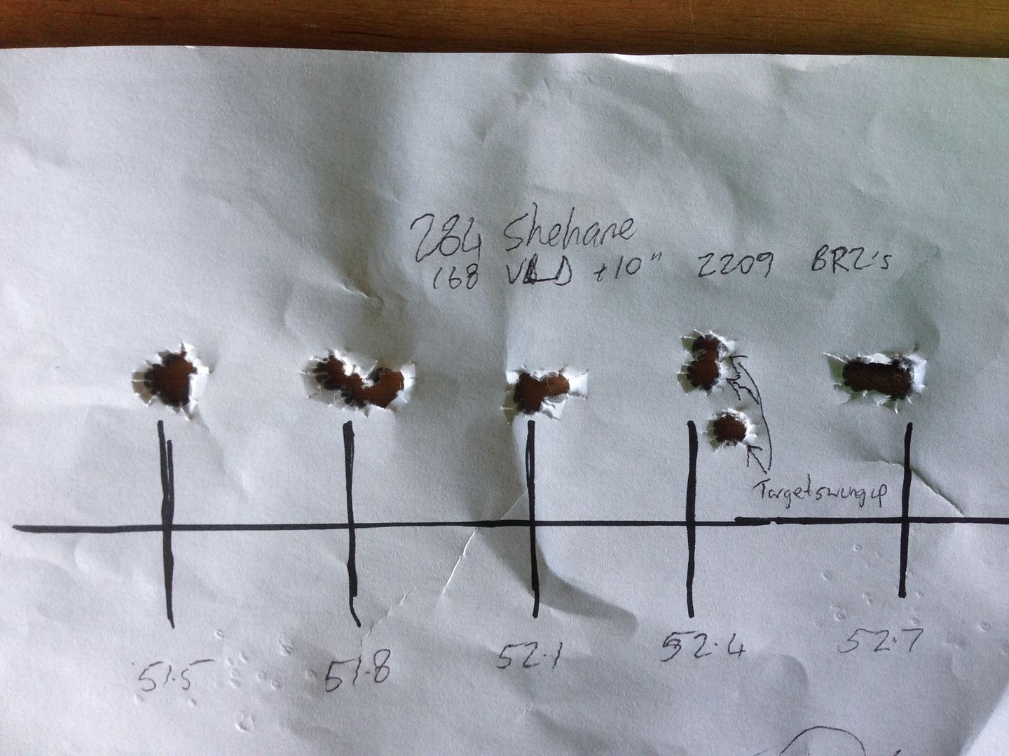

284 shooting Berger 168 VLDs with H4350. I was thinking 52.2 and 53.2 and try seating depth changes.
Thoughts?
Thoughts?
between 52 and 52.3 and 53.2 and 53.5 are definitely possibilities. Got any chrony data on those groups? The lowest ES would be the one to go after.

So what do I do now? This was shot on 15 power (forgot to wind it up to 40x on the scope- been shooting too long with a fixed power scope). I could re shoot it with the target board fixed properly as per the 52.4gr charge, and on higher magnification, and with a set of wind flags to make the groups smaller?
Chrony velocity gave an average respectively of 2810, 2827, 2858, 2871 and 2907 fps over the 3 shots for each group. ES was hard to pick any clear better charge over the other. All were between 5-10fps for the 3 shots. I like having these first world problems to deal with ;) By the way 2209 is H4350 in the USA.
Work on 52.1 while adjusting seating depth and then go back and do the final .1gr. increment testing.
