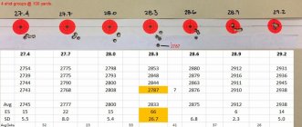

New to shooting so this has been an interesting read for me. So much to learn on this site.
At first - i just picked a few powder loads based on friend's recommendation - and as Erik mentioned, just picked one that appeared good. Been shooting that ever since. After reading this thread, decided to try load development test again.
Erik, just wondering if you have a recommendation based on this test. Didn't start lower then 27.4 (should I have?) and didn't proceed higher than 29.2 (ever so slight pressure signs). Seems I have an odd one for 28.3. Maybe I loaded incorrect amount of powder?
6br, varget powder, berger 105 hybrids jumped .005.
thanks
newbieshooter said:
6br, varget powder, berger 105 hybrids jumped .020.
thanks
What's your barrel length? The speed at high end is ~300 fps higher than Hodgdon's data for 24-in barrel.
newbieshooter said:
Sorry about that. It is a 30" barrel.
Then your results are not unreasonable considering the Hodgdon data - FWIW.
I await Erik's comments, they should be particularly instructive in this example. Nice work!
thanks
27.4 through 28.0 look good, but ES is a little high. 28.9 and 29.2 also look good and ES is also good. Adjust seating depth on 28.0 and also on 29.0 and see which one shows more consistency. Depending on which shows best accuracy, test .5 gr. in .1gr. increments on each side of load with new seating depth as long as it is safe to do so. Stop if you see pressure signs.

Erik - Thank You for the feedback!

It really looks to me that your rifle is climping into it's best load where you stopped... I don't know how many ejector marks you see at that level out of 5 cases but if only 1 or 2 I would keep working the load higher.. If not the only node your showing here is at the low end...Something tells me that if you will shoot 29.1, 29.2, 29.3 29.4gr you will find them all at the same vertical and bugholing.... Just watch for heavy ejector marks starting to show on 3 out of 5 cases... Your rifle looks to be climbing into it's best node around 29.3 for sure but we want know unless you shoot...
snowpro440 said:
Just what shootstraigh22 said , I would look into 29.1 to 30 in one tenth increments
Thanks everyone for your input. I'm still learning how to identify pressure signs. When I mentioned "ever so slight pressure signs" at 29.2 I noticed that the bolt was just "ever so slightly" harder to lift than at lower powder loads. I did not check for ejector marks. Since this is new to me - I figured I would stop there (29.2) to be safe.
I can shoot 29.1 and 29.2 (again) and check for ejector marks (I just googled images of that). If it looks ok - I'll try one round at 29.3 and check for heavier bolt lift and ejector marks on the brass. I can repeat for 29.4 if everything checks out at 29.3. I can see how the grouping goes - but given my lack of experience, I am hesitant to go all the up 30gr even in .1 increments (unless one of my more experienced friends comes along to double check everything).
