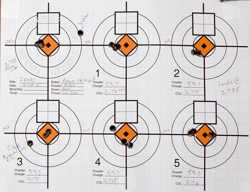

Finished my seating depth test for my 280AI, going to go with 2.775 to ogive which is 10 thousandths off the lands.
VERY happy with how the rifle shoots the 180 hybrids. The first three groups are pretty much the three best groups I've ever shot.

Interesting - is 2.775 top right? To my eye the top left and middle look to be good choices as they are much closer aligned vertically where as the top right has a POI that is significantly lower than those two.

Great shooting. 2.775 looks good. Did you shoot any all the way to jam? That would help to see if 2.775 is in the middle or end of the node.
Thanks guys.
Top left was used as a "fouler" target with four rounds loaded to 2.755 to ogive (30 thou off lands). I did that sort of as an afterthought rather than choosing to make it part of the test. Fired first round, reset my zero, then fired a group of three. I was surprised at how well it shot, it was actually the best group at 0.183".
The rest of the targets 1 through 5 started off at 5 thousandths off lands and worked up to 25 thousands off lands. I didn't shoot one touching lands. They were all shot in sequence, not round robin.
I look at target #3 as a two shot group. The "flyer" wasn't just a pulled shot, it was a "Bang! oh crap I didn't mean for the gun to go off" shot as I was settling into position. That's why I picked target #2 as the final seating depth since it had good groups on either side of it so it looked to be roughly in the middle of an acceptable node.
Do you guys use the POI method of selecting seating depth, same as you would for powder charges? I had thought I would look more at consistency of of group clustering rather than POI, since I can load seating depth repeatably to 0.001. I use the Redding competition die and measure every round with an ogive comparator tool.
As a side note, I'm not quite sure what happened with targets 4 and 5. It may have been me getting tired and losing concentration, the barrel getting hot, or simply not a good node. Probably all of the above. I would have expected target 5 to be better since it's only 5 thousands different than the first sighter/fouler target.
