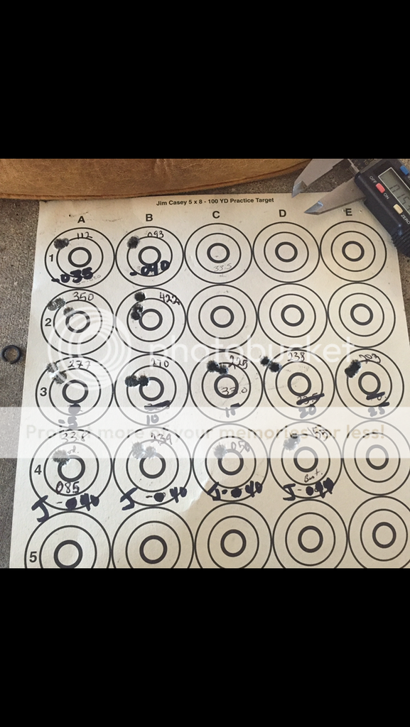

Long range load development at 100 yards.
I don't think my bullets like the 20 jump(groups really open up), but I guess that is not the point of the first round of this method. I pretty sure I pulled that high round in 59.5.

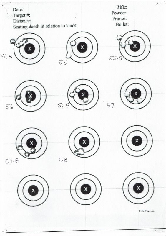

Hi folks , hope you don't mind me joining in.
No velocity figures as I run a magnetospeed and didn't want any chance of that effecting groups.
284 Winchester with 162 amax H4831SC @ 100yds . 58gr "just" started showing pressure with 1 primer very slightly cratered. Also the bullet hole top left on 54.5gr was a fouler round.
I was thinking 57.5gr and playing from there .
I also wondered that , I also done some load development with my 6x47lapua at the same time and the
POI did rise with increased powder charge.
Both new barrels with only 10 round through them.

Went through your method yesterday and selected a load. Today I finished it off with seating depth. I'm shooting a 6 Dasher using my 105 gr Infinity boattails. A couple of good things happen today. I figured out why my rifle was flipping shots and I think I have a pretty good setting depth and load. All groups are 3 shots at 100 yards.
Row 1 is my action with a different fireing pin assembly. Row 2 are the same loads with the original fireing pin assembly! As it turns out it was an ignition problem.
Row 3 are all different seating depths starting at -005 from Jam. Rifle shot pretty good but came to life at -040. It was fairly windy with a good bit of mirage! No chronograph data! My Magnito Speed won't work on this barrel. It's a straight 1.250 and my ladradar is back ordered!
Did I pass?
Bart
