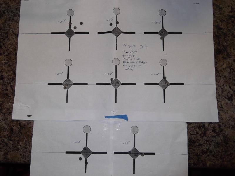

On my last outing I ran a test at 325 yards with charges from 65.0 to 66.2grs, and 65.6 through 66.2 had 5/8 to 3/4" vertical and all shared same POI. So my next test was to try Erik's method of seating depth at 100 yards in .003" increments. I've never really tested in that small of movements before, and usually tested in .005" increments. I must say I was impressed with the results.
Wind was blowing from left to right around 3-5 mph. I used wind flags, but no Chronograph.
Here are the results:
-.010"
-.013"
-.016"
-.019"
-.022"
-.025"
-.028"
-.031"
