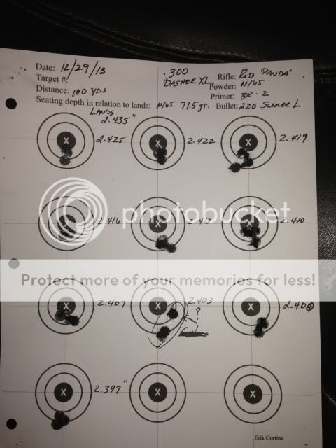

Here are the load development results for my .300 Dasher XL using Lapua 220 gr. Scenar L bullets and VV N165 powder. Primers used were CCI BR-2
Powder Charge testing.
I settled on 71.5 gr. N165 as my powder charge due to it's low ES and being in the middle of a node between 71.0 and 72.0.
Seating depth testing.
I settled on 2.399" as my seating depth because it's between 2.400" and 2.397" which shot best. They also had the lowest ES of all the groups (under 10 ES).
The reason I settled on 2.399" is because it gives me .001" room for error and it will allow the throat to wear .002" and still be in the node.

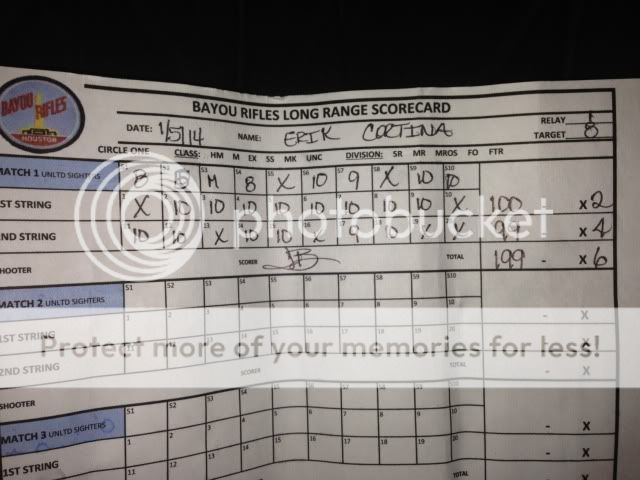

1,000 yard score.
We only shot one string because the match was called due to extremely high winds. When I shot the winds were not terrible, they were about 8-12 MPH and a switchy. Throughout my entire string I had to move around about 1.25" MOA on my hold but overall it was not too hard to read that string. Shot #17 was a "corner" 9 at about 7:30. It was still inside the 10 ring vertical but a little low and a little left.
I hope this sheds some light on some of you on how the testing works. It's pretty simple and best of all, it works! ;)
Erik thanks for the target and the explanation of why you picked them. Will help others using this method. Great shooting
Just curious, 2.425 and 2.422 hit same POI, where 2.400 and 2.397 didn't. Was more emphasis put on the chrony numbers?

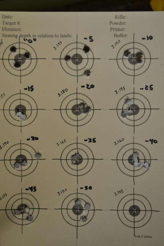

Seating depth test for 308 Savage FTR 155 Sierra and 8208 XBR. Kvb7 Lapua brass
Sure looks like -15 to -20 is where I need to be. 0.241" and 0.281" respectively back to back.
Agree?
Thanks for all the help Erik and other top shooters on the forum
