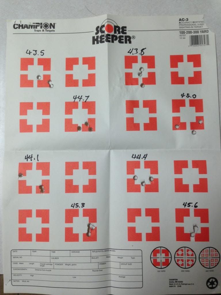

Hey Erik. Can you check this out and let me know what you think....
I took my 308WIN GAP-10 out yesterday to conduct an OCW test. I'll list all the specifics and if you could give me your thoughts on what you think that would be great.
Conditions:
Temperature: 54
Humidity: 37%
Pressure: 29.89 in
Visibility: 10 Miles
Elevation: 335 ft
Load:
Bullet: 175g SMK BTHP
Brass: Lapua
Powder: IMR 4064
Primer: CCI #34
Velocities:
43.5: 2604, 2619, 2604
43.8: 2640, 2650, 2619
44.1: 2635, 2619, 2640
44.4: 2682, 2661, 2645
44.7: 2677, 2677, 2645
45.0: 2682, 2699, 2666
45.3: 2699, 2715, 2704
45.6: 2721, 2726, 2726
It started to cool off a few degrees for the third round robin, so the velocities seem to have taken a small hit.
I'm thinking somewhere between 45.3 and 45.6. They seem to be pretty similar in relation to the center, they're tight, and the ES SD and AV velocities look pretty good too.
What do you think?

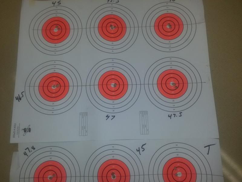

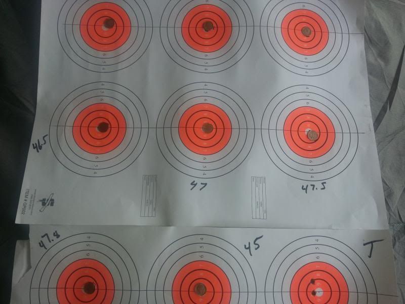

Took the GAP Hospitaller out with the new tube for some load development. I was pleased with the first round. Eric, Steve, Where would you go with this? Assuming the one round at 47.5 is a flyer, I think the waterline from 46.5 to 47.5 is good so 47 looks like the load to go with. What do you guys think?
I do like the fact that all loads printed under a dime!
Diego
Diego-Ted, I'm afraid I won't be able to help you. Apparently that gun will never shoot good enough. I'll help you out and buy it from you so you don't have to suffer with that gun anymore. ;)
Joking aside, 47.0 is what I would use. Nice shooting!
Diego Ted,
That's awesome. You can certainly not blame the equipment when using that gun.
What bullet and powder is that?
I think you should definitely sell that gun to Erik before it embarrasses you in a match! And, whatever you do, don't risk bringing it to the match next month. ;) [br]
You should run those loads over the chrono and take both grouping and ES into account. Send me an email if you need anything.
I agree with you, 45.3 and 45.6 look the best. Without knowing what it looks like past 45.6, I would pick 45.5 and test it.
Good luck!
