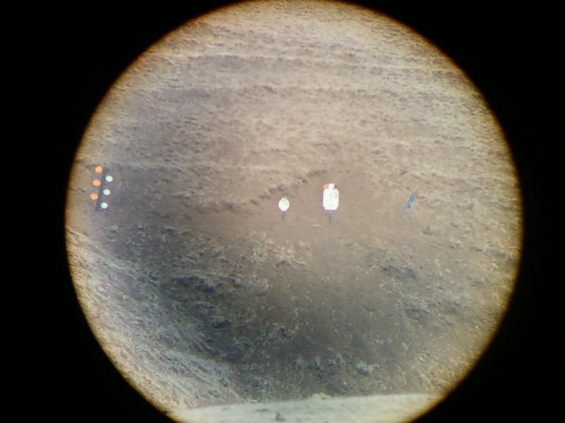

My 260 is tack driving (for me anyways) those 130 Hunting VLD's. I'm just recreational shooter, and hunter. I stretched my 260 out to 700 yards Friday, and got a nice 5-shot group around 3-4". We can't go out to check the plate , so took a picture thru my scope.
Plate on the right with 5 shots in center. Also shot round plate on the left later that day with 5-6 mph winds.
