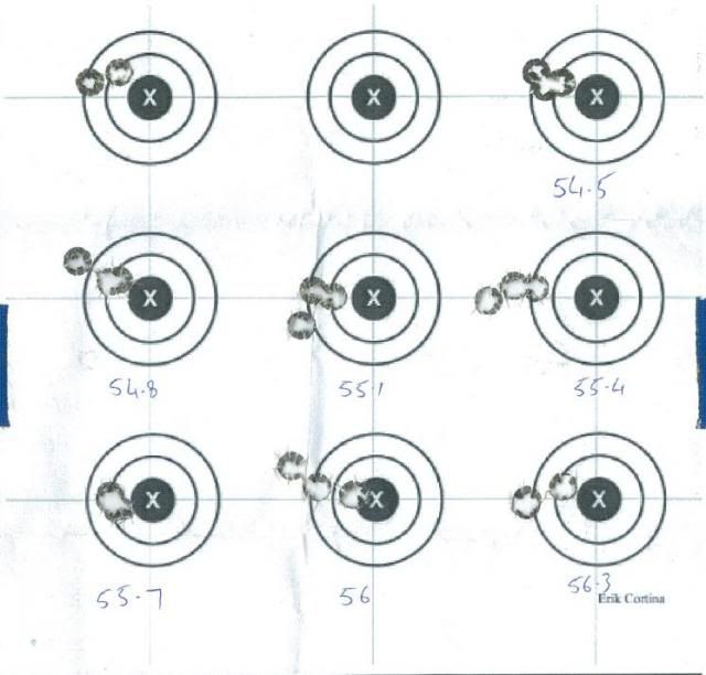

Here is one from yesterday afternoon on my 284 shehane with a krieger 5R that is being slightly painful with copper fouling and being hard to figure out in general. The shot low on the 55.1 charge was out of that group as the buddies I was shooting with at the time hit the piece of paper low where it was fixed to a cardboard box and it ended up swinging down on the right corner a little before I shot. So that shot would have hit into the others. (Ive cut their groups away so you only see mine). Two shots top left were sighters. To me I would say 55.1-55.7 would be my node but happy to be corrected. Bullet was a moly coated 180gr berger VLD 10 thousandths past touching the lands. No velocities as I havent got the magnetospeed with me at the moment, however on a past test with 180 hybrids, 55gr of powder produced avg 2890fps with naked 180 hybrids jumped 15 thousandths. I can only assume (which is not the greatest idea) that these loads would have been running between 2850 and 2950fps.

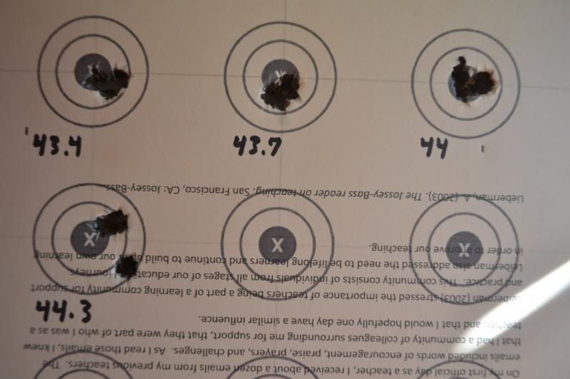

Thoughts. Erik this look better ;D. I wish I would have had 43.1 just to help see better. Amazed at how well these shot so far(groups no bigger than 0.3") and wind was kinda switchy with 5-8mph winds
no #s. Friend who has magnetospeed was working today. This look like a good enough barrel to put your tuner on? We talked before about making sure it was a shooter before we did anything on it

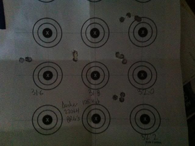

Another one this time for my 6 dasher 300-600yd f class gun. Shot round robin style, the second shot on each group seemed off and I put this down to a few swirling gusts of wind coming through- strong enough to pick up dust on the range. This was 31.6gr to 32.2gr H4895. Berger 105 hybrids jumped 50" and BR4 primers. It would be very easy to assume 31.6 is right and stop load development (even with the wind causing the flier) but Im thinking more along the lines of 31.7 and playing with seating depth (going closer to the lands). From discussion this seems to be in the region for an accuracy node with H4895 but again no velocities as I dont like the magnetospeed on while shooting groups.
