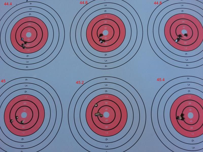

Long range load development at 100 yards.
Erik Cortina said:
Looks like the came together pretty good. But if it was that windy, you may have to do it again to see results more clearly.
Were you adjusting seating depth in .003" increments?
Yes it's a little hard to see my notes in the pic, I went left to right. The first target was a fouling target to get rid of a few odd loaded rounds. I started on the second target at 10 jump with 4 rounds each till I finished the 40 jump with five rounds.
I'm going out today to test seating depth on the 44.5 node. Hopefully the results wont be so garbage looking.
Well today didn't fair as well. Just as windy(typical for Northern Nevada till late summer.) This time I didn't have anything close to the results of yesterday.....just plain ugly. I had rounds going places that I didn't even anticipate...just plain weird. I'm guessing the node wasn't the ticket and none of the seating depths were close except the starting Jump of .010. I wonder if this node(if it is a node) needs to have the bullet jammed?
Back to the original node to see if it is repeatable.

Eric, My turn, my turn, I went out and did some develpment with the newly worked Savage tube. 178 bthp hornady, Varget, lapua brass FGMM 210 primers. I am not sure what to make of it? Did I blow the test by shooting 4 shots? the 45gr test only has three, I used one for a sighter??
Thx Ted

do you have your seating depth target? Most likely if it was shooting 1/2 MOA at 100 and you took it to 300 and it shot 3 MOA or worse than it could be the shooter or scope rings could be loose or action screws loose? Also if you were not paying attention to the wind it could be another factor.
Erik's analysis seems correct. Personally, I don't care for long range load development at any range less than 400 yds. to start. I prefer ladder testing at 600yds to find the best vertical dispersion. if you are going to shoot long range, then test your loads at long range. Just my 2 cents worth.
