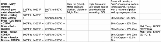

I don't think I posted a link to this useful table of annealing temps and colors of various metals
Here's a snip of the section re brass. Columns 2 and 3 are the annealing temp range. The next column describes the color associated with that range. So from that faint, dull red to bright red. If you're into any sort of orange you're going too far.
