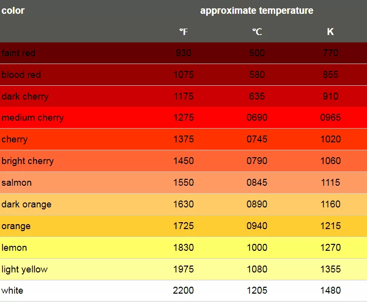

Back to just temp. The cool thing about looking at a glowing object is that the temperature of the glowing object can be determined by its color and it virtually doesn't matter what the emitter is (brass, steel or whatever). See the chart below. Yes, to reach 1kF it "the brass must glow" but only barely so. 1000F is a glow that barely makes it into the visible spectrum - it's just detectable with the naked eye albeit just as well for us that it skimps in. But it's a very faint dull red (in a dark room). If you are seeing anything in, for example, what the chart below calls 'bright cherry' you're waaay over 1kF.
metal-color-temp-chart-png.100306
One additional thought. The wavelength of light in the visible spectrum is between approximately 380 and 750nm, 750 being at that barely discernible "faint red" end of the spectrum. But something glowing very faintly red is emitting far more than the light we see. It is giving off much more radiation at far longer wavelengths that we don't see but rather feel in the form of heat. I believe Wein's displacement law can be used to determine this peak wavelength emission.
A sensor trying to detect fire will have an operational spectral bandwidth: "760nm to 1100n" in the case of your sensor. This sensor range needs to 'conform' with the ability to detect that faint, dull red that's in line with your target 1kF. A bright fire is by definition much hotter than a dull red cartridge case. It's peak radiation will be at much shorter wavelengths.
To apply Wein's displacement law to 1kF (= 810K) I think (note italic emphasis) we can simply drop in 810K into the formaula and get a peak radiation wavelength of circa 3,573nm. In contrast, the color temp of a candle flame is about 1800K with a peak radiation in the 1610nm wavelength.
In short, I think you need to be wary of such detectors and their operational ranges and hence their suitability for detecting reliably what are, in the scheme of fire detectors, relatively cool temperatures.If nothing else dial up their sensitivity to or near the max.
