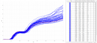

Granted , this is not the same cartridge but maybe similar enough that some folks will find it interesting or helpful when it comes to the FCP . Here are some results of a 7-6.5 PRCW pressure test that was done by Frank at Bartlien with the help of the fellas at Hornady...
