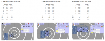

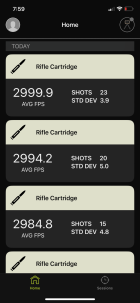

I'd like to hear from other FCP shooters who were using RL16 - where did you land with your load, how did it shoot, and how was the powder behaving with temperature swings?
This looks like a wide node, but I’m not sure how the brass will hold up at that velocity.
I am at 55.6 at your same velocities so you are right where you need to be. I am at about 80-90 ambient so if your a bit cooler would explain the slight increase in charge.
