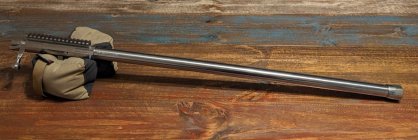

I’m almost ready to start fire forming got my 32” Blake barrel chambered and installed on my BAT action. I have H4831SC and H1000 available to fire form with 180 hybrids. Any one have load data for H1000?
