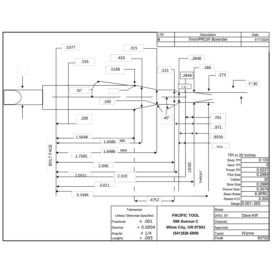

So does the current FCP reamer have this Bore Rider freebore lead angle.
I have been studying some pt&g reamers with it, particularly the pt&g 7-6.5 PRCW bore Rider print.
The freebore lead angle length looks huge on it, like doubtful you'd ever have bullet touching lands. Maybe I'm reading it wrong.
PRCW is a 1 degree lead angle. It is not a bore rider throat. Totally different things.
Sorry guys, here is the link to the PT&G reamer that has references to PRCW and the bore rider feature, it does have some wheeler specs I guess.

Anyway curious about this Bore Rider feature and if it's part of the current FCP reamer.
Would be interesting to see the FCP with the wheeler 1 degree angle.
You do realize that the 1° was setup for a specific bullet and any other bullet used might not be optimal?
Yes I know this, do you have any evidence it doesn't work with other bullets, also maybe I like the bullet it was setup for, maybe I want to shoot that specific bullet out of the FCP cartridge.
