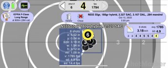

184gn Berger Hybrids
CCI BR-2 primers
.015” jump
Ladder test on quite windy day (875 yards)
N555 56.2gr - 56.6gr - 57gr
180gr Hybrids
CCI 200
8 rounds per load
