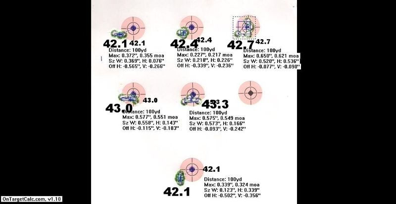

Seems this load is holding. First target is day one of powder testing I did.
Initial testing
This next charge test was completed after I selected a seating depth(seating test was on another target)
The final test was done to confirm and try one charge lower to see window. Top row is 42.1 and continues to 43.3. Bottom tarrget by itself was sighters at 42.1gr
Seems like 42.1 to 43.7 is window that shows stability?
Initial testing
I would stay between 42.1 and 42.4
Thanks. I may investigate the higher node later. Going to shoot 42.1 to 42.7 at 1000 to see. Seems 43 to 43.6 might be something? If I tweaked seating depth again

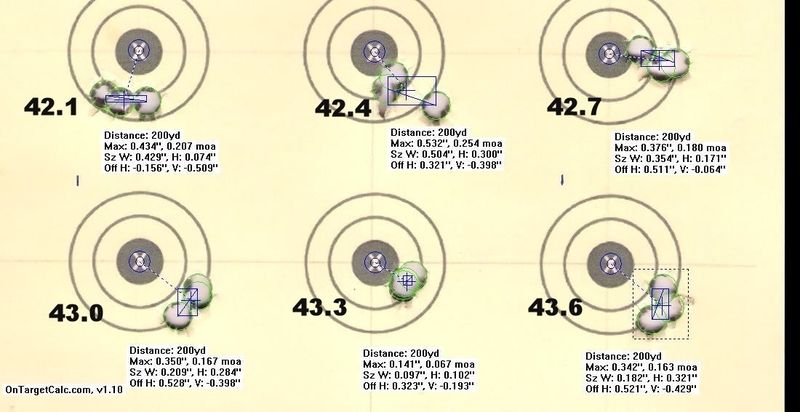

On the upper target, it says 200 yards and shows a very good MOA for that range. Is that legit or did you have the wrong distance dialed in to the On Target program? That's something I've done in the past.
It was all at 100 yards. I just noticed that
I've done that myself after shooting at 200 yards. When I score the next batch (shot at 100 yards), the 200 yard distance "sticks" when using On Target Software. My first thought is, "Wow............. these are REALLY great groups". Then comes the agony of defeat when I realize I had input the wrong target distance. Changing the distance to 100 yards brings me back to reality............. sigh.
