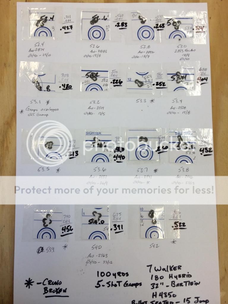

Final Testing - Everything put together. Crony broke today, so missing numbers on some groups. It appears that the gun has a large node between 52.6 and 53.5 I need to retest 53.1 and 53.6
I plan on shooting 53.3.
