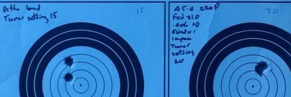

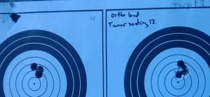

Thought I would post my tuner groups. This new load was harder to dial in than the original load. It is incredibly interesting and so fast all up though.
I have just posted the pictures of relevant groups to look at - other groups were tightish but not good enough to bother with.
I got to settings 10 and 12 and thought it could be worth going back and looking at 11...I might do this some other time.
I figured I needed to make some stronger changes so moved to 15 and then 20 - bingo, I then moved to 25 (equivalent to 1 full revolution) and then back to 20. I have left it on 20 for now. 20 looks to be very repeatable.
I noticed that while the two groups on setting 20 were tight the POI moved but I am guessing this is due to the way I tightend the grub screws or maybe I don't have it in precisely the same place?
When bullets arrive I have seating depth to play with and to look at tuner settings between 20 - 25?

Have you been able to shoot with the tuner on 20 at 100yds then take it further back to 500+yards yet? Has it stayed tight or do you need to adjust it for the longer range? After a rechamber Im now back to 56.8 powder with a 180vld in my shehane jammed 10 thou and 57.0 with the same bullet jumped 40 thou. Both loads shot well at 700m today but I havent had the chance to adjust the tuner yet to see if any will shrink down, nor have I been able to get an ES or any idea of velocity.
You will not need to adjust the tuner for various distances. It is important to note that a tuner is not a panacea. Orderly load development resulting in low ES, broad charge window, and seating depth set correctly is still necessary. If all that is in order, correct tuner setting will reduce dispersion further and slightly broaden the node by aligning barrel harmonics to coincide with the center of the charge window. This approach and Erik's tuner has made my .300 WSM a very dependable and forgiving rifle through several barrels.

Hey Brad,
My experience so far supports Steve's and Erik's views. Once set pretty much leave it alone.
I haven't used setting 20 past 100 as I have only just worked it up. I had used 44.1 and setting 8 from 300 - 1000 (the initial load selected). I had a tough time at 1000 but it turns out that load was marginal at 1k. I have cleaned 300, 500 and 600 multiple times and dropped 1 at 900. I had one good day where all the local clubs have a midrange shoot off and I never dropped a shot from 300 - 600 including sighters (it was the sighters that made it)...not bad for what was effectively a 40 shot load development.
