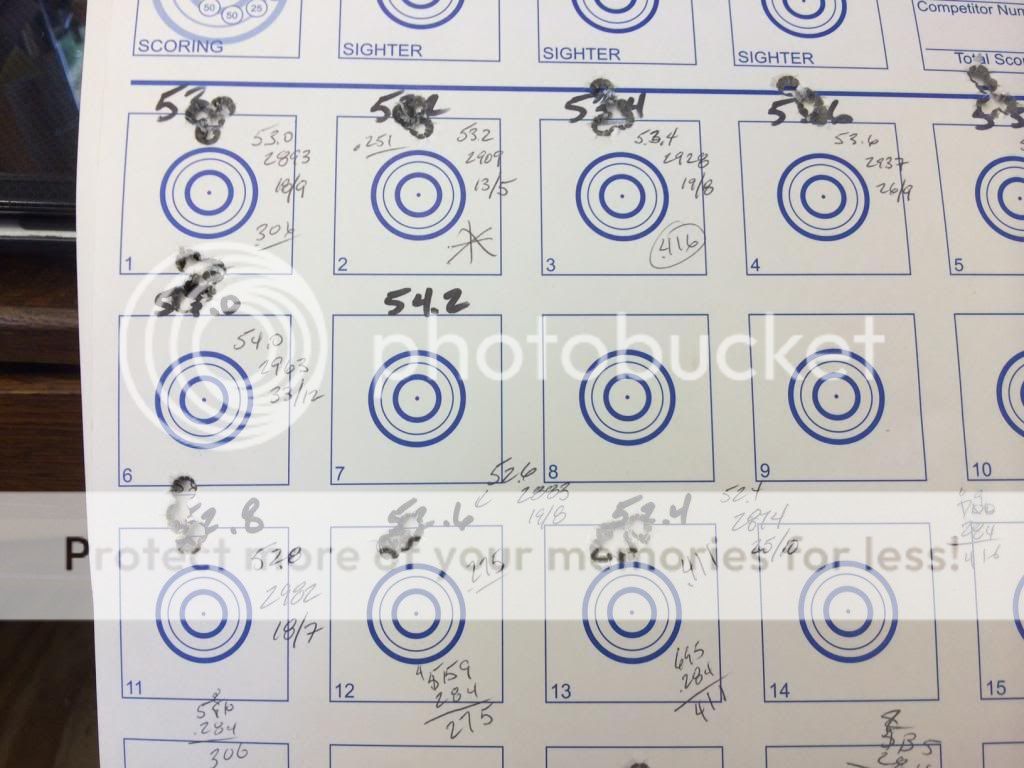

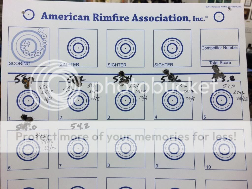

stopped at 54 grs as it was taking me out of the velocity range I was wanting to shoot. Bolt left as still good, but I could here the prime pockets screaming. This is just my powder test. Think I'm going to go from 52-53 tomorrow as I was hoping to be shooting it around 2850 to save my brass. After I do that and settle on powder load, I'll do my jump testing at 300 yards. These were all seated for a 15 thousand jump, 5 shot groups, good evening at 100 yards, all shoots were called and correct.
Try 52.0 - 53.0 and see why they look like. I can clearly see where all the groups kept climbing. Good barrel for sure.
I'm going to test mine Saturday, we'll see how it goes.
Thanks for posting those groups! I for one would really like to see the 52-53grain results, and then read Erik's analysis. This way of looking at charge weight testing is new and intriguing for me.
Brian

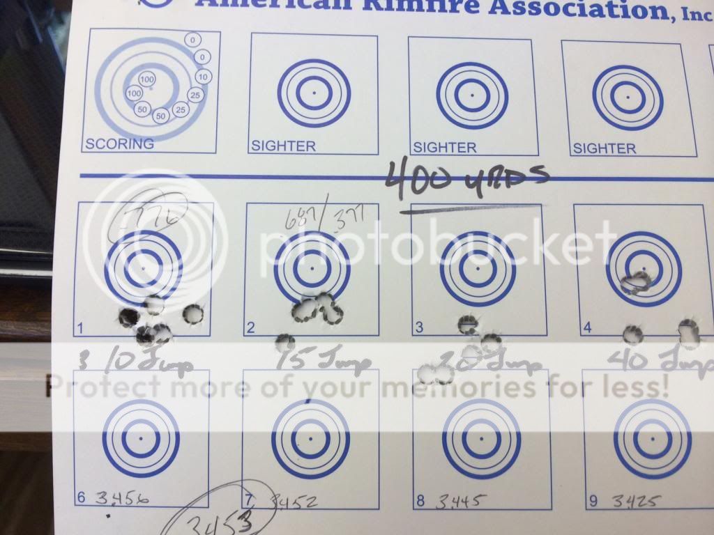

I only loaded 52.8, 52.6 and 52.4 for the powder test this morning. Looking at the results, I'm reading two nodes, one between 53.0 - 53.4, and another one between 52.4-52.6. I suspect that if I'd loading some 52.2 they would look close 52.4, but again I'm wanting to run the gun in the 2880 range so it worked out perfect.
As for the jump test, it really surprise me as I was expect the 40 jump to preform the best. The conditions were OK, but not the best..I still can't be sure if I pulled the one shot or not at 15 jump. Since I wasn't sure before going to the range what I'd find below 53, I did all my jump test at 53.2grs
My load will be 52.5 grs, jumping the bullets around 12 thousands..
Question:
What's there to choose from between 52.4, 52.6 and 53.0, 53.2?
I like the 53.0, 53.2 groups better, and they seem to print at the same vertical displacement as 52.4, 52.6.
What am I missing in the selection algorithm?
Brian
I choose the lower node for a couple of reasons. One being that the lower node should extent barrel life a little, and its easier on my brass. Second being that if I end up shooting somewhere where the temps are very hot, shooting the lower node should push me into the second node area, the though being that the gun will shoot out of one node into the next with the higher temps. If I go somewhere where the temps are cold, I'll load to the higher node.

When you test seating depth, only move .003" at a time.
