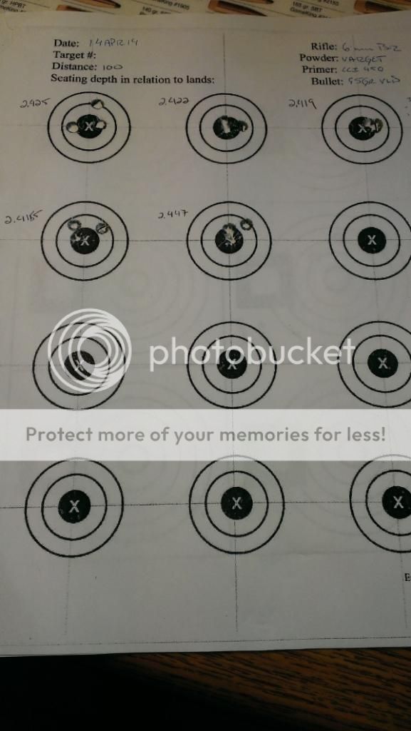

Long range load development at 100 yards.
Hello again,
Here is another seat test target that I shot today. Pretty windy today. Same powder charge and neck bushing. I like the 2.419 group. It's .018" jumped. What do you think? The raw group is .375" with the minus .243"+ .132".
Thanx again
Thank you again Erik. Would you load to 2.419 or go between that and 2.422? Would that be the small window of accuracy?
Thanx again
