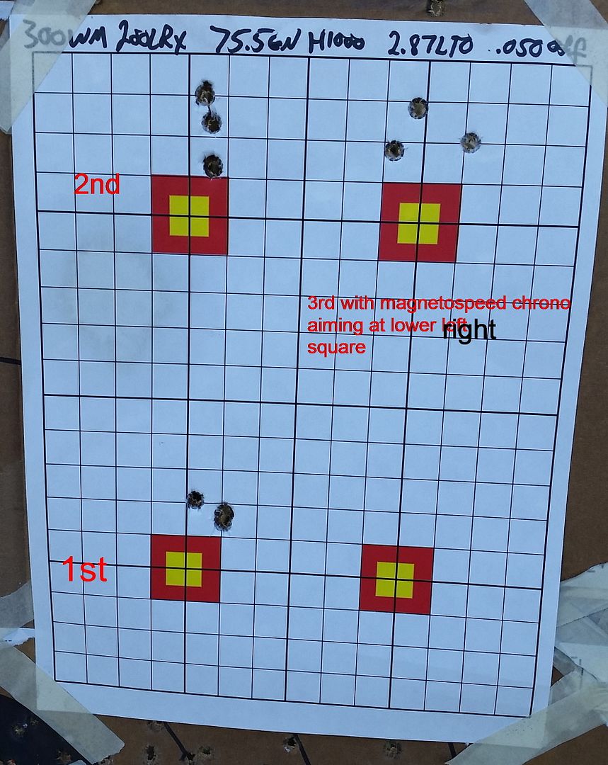

I said i would report back so here is what i came up with.

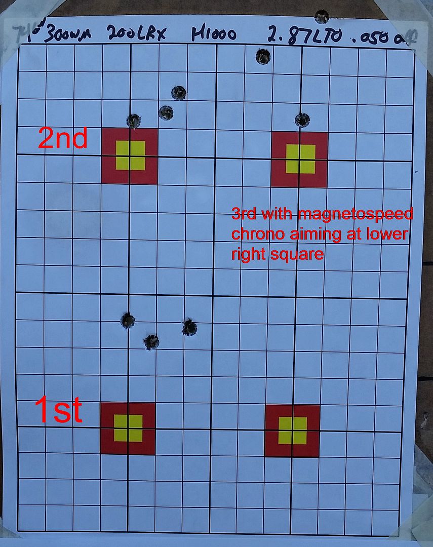

my test with rl22 failed the second test -- temps came up which caused sticky bolt -- was pushing on upper limit and rl22 just isn't temp stabil. So i changed to H1000 re ran the test here are the pics
300 wm 200LRX H1000 74gn
Series 2 Shots: 3
Min 2881 Max 2905
Avg 2892 S-D 12
ES 24
Series Shot Speed
2 1 2905 ft/sec
2 2 2881 ft/sec
2 3 2891 ft/sec
300 wm 200LRX H1000 75.5gn
this is the load

on this target the bottom group on the left poa was top dot but i didn't reset scope after installing my new trigger. i adjusted 8 mil clicks up after the group. i compared it and it had similar poi as the rest. so then i shot the 74 grain load at the top left dot.
I was torn on which one to use so i loaded 9 rounds of 74gn and 9 rounds of 75.5 grains then shot 2 3 shot groups of each then installed my magnetospeed chrono to check velocity on the last 3 of each. -- the magnetospeed chrono shifted my poi up 6" and effected the 74gn load more than the 75.5.
so looks like the 75.5 wins out at 2950 fps average for 3 shots with es of 12 since it is a hunting rifle and time is short not going to run a seat test the bullets are expensive also
thanks again to all those that help out in this thread.
the 73 is actually 74 i swapped them on the target because my scope was off on the first group.
that is why i tested the 74 and 75.5 but on the second test the 75 seems better i could be wrong new at this game.

Personally I would be inclined to work on the 74 gr group. Yea the 75.5 shot one smaller group and then shot a group similar to the 74 and was vertical. The 74 only had horizontal in both groups is why I would pic over the 75.5. What were the ES and SD on 74

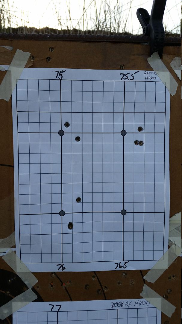

I torqued everything I could and I did not find anything that was wrong mechanically. I tried another seating depth test with the dasher. It looks like it prefers to stay closer to the lands. Sorry for posting my 200 yd groups but the area closest to me for testing is perfect for 200 yards but if I try to do 100 yards I would be shooting up a hill. The only other 100yd - 1000 yd range is a 30min drive…. comments welcomed.

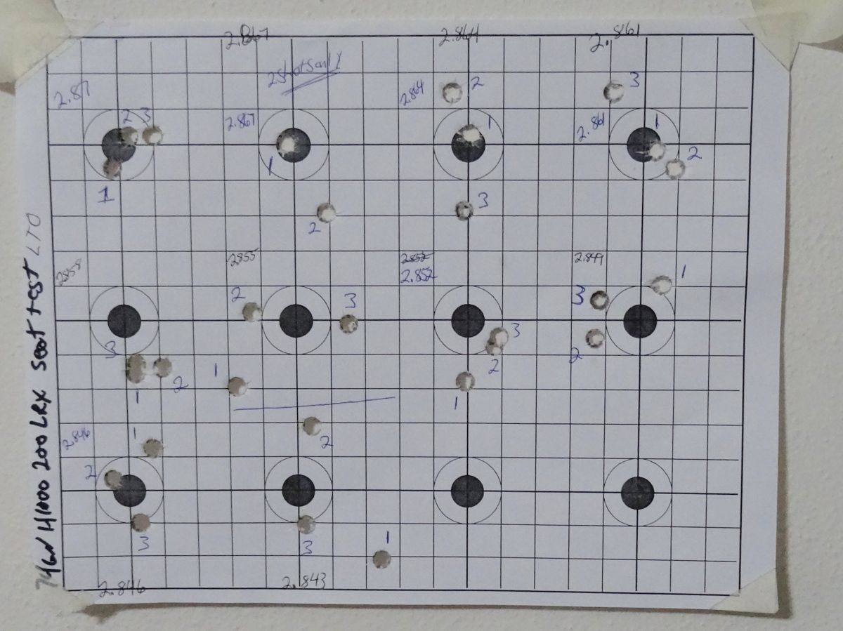

I took the advise of you guys and did a seat depth test with the 74gn h1000 lrx 200 300 win mag, stock 700 adl
all groups were shot with a 8 - 9 minute cool down between groups chrono check after showed 2868 av fps.
So which depth looks best? i am thinking 2.858 am i right? thanks again
