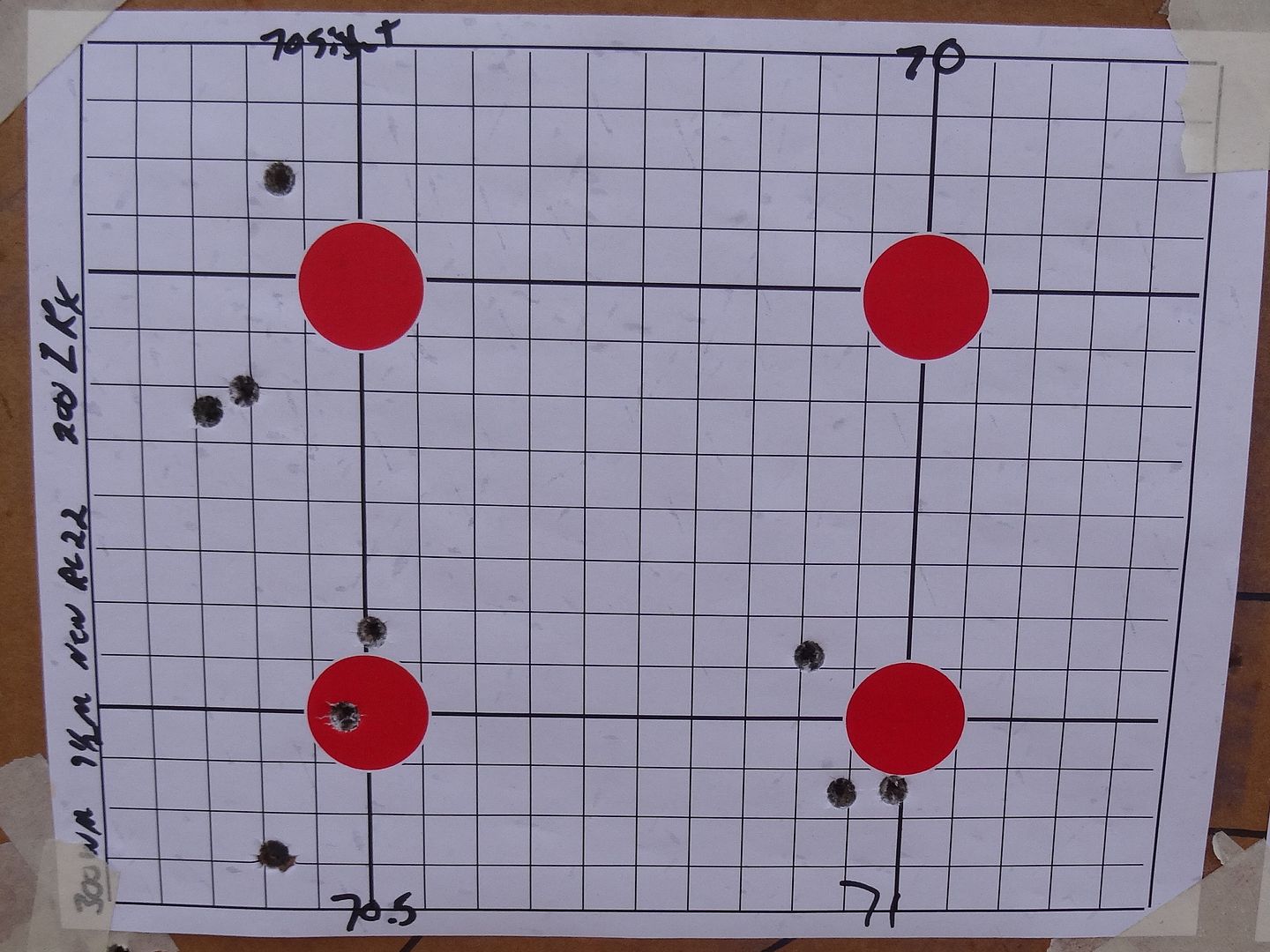

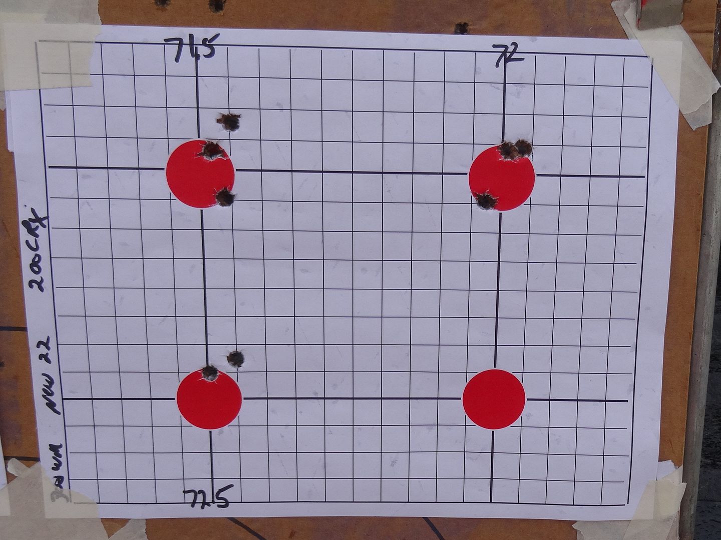

First off i want to thank Erik and everyone else for this awesome thread. I am developing a hunting load for my 300 win mag using rl22 and 200 barnes LRX. gun is a remington 700 adl with pillars and beaded boyd's stock. barrel is the stock remington 26"
here is my last target out shooting off bipod with rear bag.
I was thinking from what i have read that i should maybe run 72.3 and do a seating depth test. these were shot at 3.35
is my thinking correct? how far do you go on your seating test? was thinking .003 steps from 3.35 -3.372 does that sound reasonable or do you have to go farther? i won't be able to get to the lands and stay mag length, lands with this bullet are at 3.582 mag length is in the 3.43 range.
thanks in advance for the help
I like to cover a .030" range with seating depth. So I load 10 groups in .003" increments. I would try it with 72.0. 72.3 is also a good choice, but looks like 71.5 also hit same place vertically. Good luck and make sure you post results on this thread.
thank you, I will load 72 and retest. and yes i will report back. this info is invaluable. thanks for taking the time and helping everyone.
