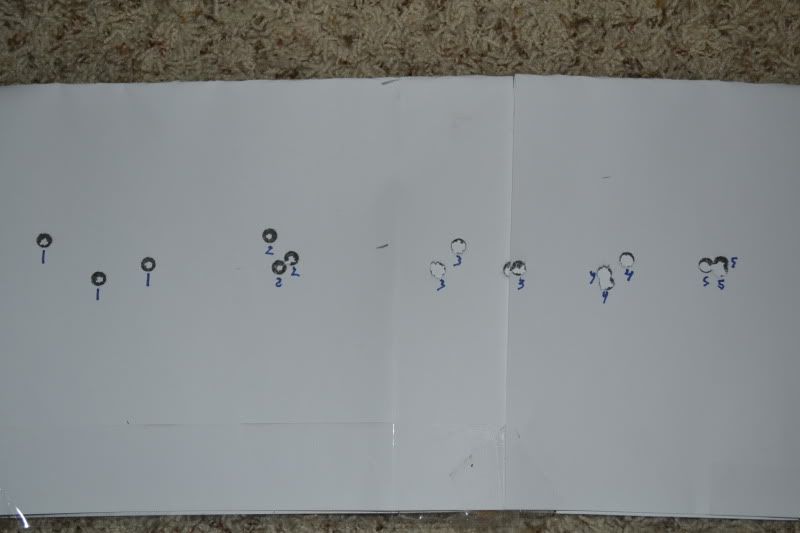

Andrew not speaking for Erik but here is my last target show seating depth test. The furthers on left was jumped about 0.120" and the far right one was jammed 0.010". And look at the difference in groups as I get closer to the lands and eventually jammed. This was shot at 100 yards same day. Barrel cooled between groups
**I used Bergers seating depth for target shooters method to do this test**
