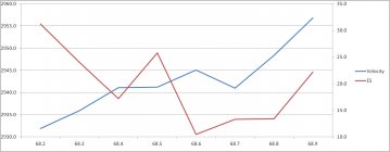

CatShooter, the velocity curve will not flatten, but the speed will increase less per .5 gr of powder.
For example, on my 7mm FCM the ES for .6 gr of powder is 35 fps.

Here's an example from .300 WSM load development. From 68.4 to 68.7, there was little velocity change. Velocity had been climbing incrementally up to 68.4, when it flattened. Lowest ES also occurred at 68.6 and then rose quickly after 68.8 as pressure approached maximum. [br]
I later shot five 5-shot groups of 68.6 and 68.7 and confirmed this series. This is typical in my load development of several cartridges.
