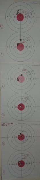

Hi,Erik
this is my test with my BCM barrel block 6.5 x 47L with Lapua Scenar -L 136 and IMR 4350 from 38.5 to 41 grains. I don't see any node, but only 3 shots in one hole with 39.5.
Neck 0.012
bushing 0.286
neck tension 0.002
cci450
oal 2.023 at the land
free bore 0.005 in the land
col 2.736.
2904 fps
16.64 ES
08.30 SD
What do you think?
I tried loading 41.5 but I couldn't seat the bullet, there was too much powder in the case. No pressure signs at 41.0.
Which can I do before the next match at 600 yd on 21/07/2013?
PS: The first down target is 38.5gr,2815fps,03.93 ES,02.00 SD
Thanks,
Jenius
