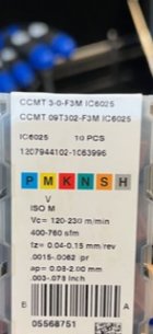

I use polished Trigon for Aluminum when roughing. With proper speed, feed, and DOC you can make the chips break like golden springs. Dry on SS 416 barrel.
Lol. I jut took this picture and was logging on when I got your notification! What speeds are you running?20221231_191554.jpg
310sfm
.004/rev
And .025doc spray these into the chip tray with my normal insert.
That is very similar to the ones I use. Great finish. Easy to break the chip. I run 8-900 rpm turning shanks. .035-.050 depth of cut.
CCMT is my go-to for both turning and facing.
