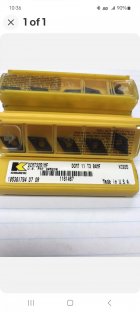

I've tried everything from $25 inserts to $1.50 inserts and for the most part there's not a radical difference in either if the insert is relatively new. The more expensive ones don't last any longer. I do like these. They seem to be pretty good and give a very nice finish on stainless. Then they dull up and eventually give the same finish as the cheap ones.
When I'm doing contouring I just use the cheap ones the same shape as these.
