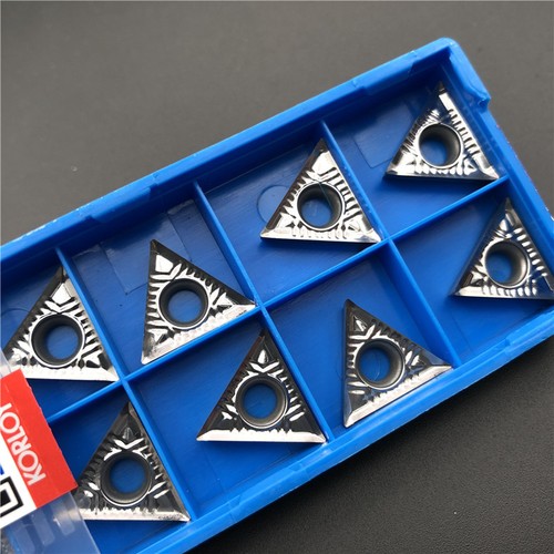

Like these?
FomaSP Carbide Inserts for Aluminum DCGT32.51 / DCGT11T304 for Turning Cutting Tools 10 PCS https://a.co/d/eZkkbOv
Yes. I generally look for Korloy or Mitsubishi in the polished types... Not sure it matters but that's what has worked for me. Maybe 10-12 bucks for a box of 10.
For non-polished stuff I really like Kennametal KC5010 grade. Works well at ~400 RPM on 1-2 inch diameter stock, which is comfortable for a new guy like me
I've also found that the chip breaker in the ground and polished aluminum inserts doesn't work on SS so you end up with a bird's nest.

I've posted this elsewhere before but not much has changed. In addition to the following I do have some Seco for rough turning and some Korloy polished inserts designed for alu but used for most anything. I also have some hand ground HSS for some things but the below are my main carbide tooling I use most often:
Circle Industries QCBI-375-6-5R Carbide Boring Bar w/TPCH-2205-CG5 Inserts.
Circle Industries FCBI-250-4-5R Carbide Boring Bar w/TDAB-505-CG5 Inserts. Pre-boring chambers.
Kennametal E08SDUPR2 Carbide Boring Bar w/DPGT2151HP KC5010 Inserts. Sharp high positive insert.
Kennametal SDJCRF082D Turning Holder w/DCGT2151HP KC5010 Inserts. Sharp high positive insert.
Iscar SWAPR-1414-06 Turning Holder w/WPEX060402R08 IC908 Inserts. Honed, sharp.
Iscar SER0625H16 Threading Holder. IC908 grade inserts. I mostly use full profile inserts.
Iscar SIR0375K11 Internal Threading Holder. IC908 grade inserts.
Micro 100 BB-1801500 Boring Bar for small chambers like PPC
Carbide Depot has been the best price I’ve found recently for the Iscar inserts. Cheaper than MSC for sure.
Do you have a link?
That's the style / shape I use a lot of. I like them for turning tenons.... Makes a relief/chicken groove really easy. I really just look for a "name brand" polished insert that's the right size. They all work well.

I like the 55* diamond DCMT shaped inserts for working in relief grooves and such. Like others, I switch to a sharp DCGT ground insert designed for aluminum when I need to shave .001 off a shoulder or other light cuts.
I switched to the 35 degree "V" inserts from the "D" years ago- gets into tighter spaces...
Great for plunge/undercuts, profiling, facing; I rarely use any other insert for turning.
