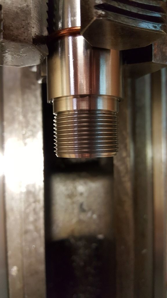

I did tons of threading with shop-ground HSS tools. It was R700 receiver truing that got me started with inserts. Seemd the only way to properly pickup a thread and to cut it oversized without a lot of extra work was to use a full profile internal insert. The Full profile inserts cut the crest for you as well as the v-profile. When truing a receiver, this is key to obtaining a good internal cut that is going to match a barrel cut to ISO specifications. No guessing on the crest flats to pitch-diameter relationship or the helix angle. Just concentrate on picking up the thread.
I have had great luck using Arthur Warner 1/2" threading kit. Its HSS, never tried carbide, so I have no comment there, but I run 79 rpm, and HSS works at that speed very well.
I tried the Warner, but I couldn't stand running slow, so I went to carbide. Warner makes a great tool though. Those are great threads btw.
I also use high speed 5 to 8% cobalt and Hillbillysniper did it right , thats how i do mine also ! I grind my tool bits for most of my turning , touch them up with a stone and you will b good for a long time ,just use high sulfur cutting fluid !

I grind my own as well. I definitely prefer HS tools for trueing action threads. I like to "feel the tool in" when I pick up the thread. This can get expensive with carbide tooling unless one is very careful
