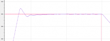

First attempt at a closed-loop PID control of induction annealing temperature using industrial pyrometer. Setpoint is 400°C (approx 750°F). Once settled the temperature is held to within +/- 0.5°C (approx +/- 1°F).
Time scale?
The width of the setpoint step is about 9s 11s [Correction]. First crossing of the setpoint occurs in about 3.3s. Horz axis shows sample count, with samples at 50ms interval.
This is not the final coil, so I expect faster rise time with a better matched coil, and with that in mind I haven't spent too much time tuning in its current configuration.
The width of the setpoint step is about 11s. First crossing of the setpoint occurs in about 3.3s. Horz axis shows sample count, with samples at 50ms interval.
Typical Closed Loop performance - great. Could you provide some electrical circuits details and hardware arrangements?
Re - The initial 750 F for 3.3 sec (may be more) - You are correct about the efficiency of the coil. What was the case? How do you determine the time to stop annealing?
In mine built the crossing of the set point (1000F) is around 2 sec. Then the process continues to a total of 5 sec (I use ferrit based inductor ).
Re - 50 ms sample - Is it the limit of the presented system?
Mine sampling limitation is determined by the SSR. The algorithm samples every 10 ms for a deviation of +/- 1% at 1000F.
It's just a suitable MOSFET, plus a zenner diode for each HEXFET on the oscillator, as described by various others here previously.
What was the case?
.308 Win.
Hardness testing.
No. I guess the limitation would be temperature feedback, which arrives every 1ms. The control loop and output stage could probably keep up with that even on the current (slow) hardware, if it was desirable.

I assume that you are using separate PID controller or may be Arduino based PID algorithm or something else. How do you interface the MOSFTs?
PID is implemented in Arduino code. Arduino output switches the MOSFET, which turns off the HEXFETS via zenner diodes.

Excuse my curiosity, but I would like to see how do you physically monitor the temperature of the brass neck. My flame sensor is an inch from the neck and protected from outside light interference.
Similar. The pyrometer head is about 1" from the case mouth. There's a photo of the test setup a couple of pages back.

I am assuming that the adrino has a PWM output that is driven by the PID loop output. I would be interrested in seeing the PID output. I am assuming large proportional contribution that will drive the output fully on at the start and collapse to nothing at the first set point crossing. I would also assume that the holding output being the Integral would be a value that at a steady state would keep the case at set point for an extended period of time. This would be a number that would be equal to the heat losses of the case. Then I also assume that the time at setpoint would be fixed for each different case. Just wondring.
Really nice work. I like changing the setpoint at the end of the cycle and letting the proportional turn it off. Ineed to read some some but it looks like the board or coil warm up as shown in the ramp up of the current. Few people will understand the effort you put in this control function. Nice job thank you
