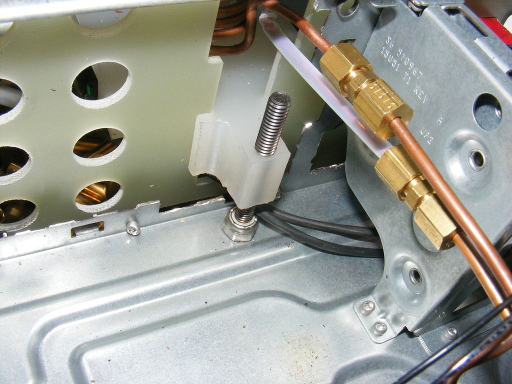

How much height adjustment do you have in the shelf?
What's the white cylinder on top of the shelf? Is it to center the cases?
I'm racking my brain to come up with a good way to make something that can easily be adjusted for centering different case diameters.
Is your coolant not going to be a closed loop system? If it's closed then you don't need to worry about the coolant level right?
Keep up the good work and thanks for the update with pics.
Shelf moves about 2 1/2". The platform is in a t-slot in the face, a simple threaded rod on a knob on the bottom is captive but free to rotate in the bottom case panel, and the platform has threads. White cylinder is the teflon 'guide' to keep cases from bouncing out, is case family or diameter specific 223, 308/243/22-250/6BR, 300WM. Coolant is closed loop but want expansion room and venting.

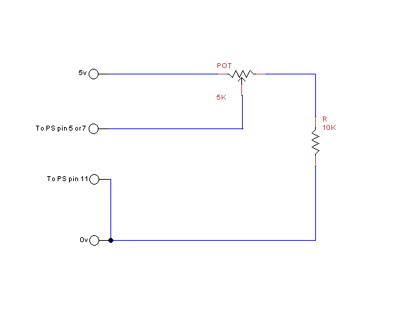

I'm getting ready to place my Jameco order, including the 750 W power supply you're using. Any recommendations on a 5vdc supply and precision potentiometer to adjust the voltage the way you outline?
See a few pages back on the 5v linear regulator and sub board.
In your case you can buy a small 5v LR for less than 5 bucks online.
https://www.amazon.com/dp/B01G3KLPUO/?tag=accuratescom-20
I'll draw up the circuit to show how its done, but in essence you put 5v into leg A of the 5K or 10K pot, the wiper leg B goes to your PS adjustment pin 5 and/or 7 , and leg C to 0v along with sending this 0v to PS pin 11. This results in a voltage range of 0v-5v on leg B. If you add a resistor equal to the pot (5K or 10K to match the pot) between leg C and ground this results in a voltage range of 2.5v to 5v with no other circuits included BUT they don't tell you there is a 6K resistance between pin 5-7, and 11, so there are parallel resistors which change things a bit.
So to get the proper voltage range you want a 5K pot with a 10K resistor between pot leg C and 0v. This should result in a 5v to approx. 2.15v adjustment range.
