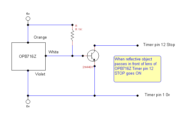

Here's the schematic for the drop tube mounted reflective IR optical stop switch. Must have a 5v supply.
Why put a "stop" circuit in it? Just leave the timer in "one cycle mode" (single shot mode) All will stop after the last case and will start up again when a new case falls in front of the start sensor.
Gina
Because if you don't, cases will drop on top of one another. The Dillon case feeder doesn't always fill every slot with a case, so you need to set timer C long enough to insure a case drops, then STOP the case feed motor so another one doesn't drop, and the trap door is reset to closed. STOP is to terminate Timer C as soon as possible.
I didn't want to change or modify the case feeder at all, so it simply plugs into a 120v outlet on the back of the box that the live leg is controlled by Timer C via a relay. In case you're wondering I've used mini 30A 12v automotive relays many times on sub 1/2 HP AC motors and heater elements with 12v relay coil control, they work just peachy and last.
To better understand your set up, what turns on the case feed motor? I know you said timer C. The NO contacts are used for the trap door solenoid, so how are you set up ?
BTW Not having used 12V auto relays, all I can relate to is the problems Jose was having with them.
OK I got !! it with your stop/start circuits. Had to mentally add them in to the system.
Gina

Timer C increments to set point. Timer C is fed 12v (or 0v to 12v PS gnd, doesn't matter its DC can switch either low side or high side of the load) on the common terminal, and the NO terminal is connected to a 12v relay coil to operate the case feed motor, the 12v trap door solenoid (and in my setup the counter input). Timer C set point must be a fairly long set time to allow a case to be picked up by the case feed plate and dropped into the drop tube. Case trips the STOP optical switch for over 100mS at the very top of the drop tube, the case feed motor stops, the trap door closes in time to catch the case. Case drops down into START switch beam and the process starts over. Timer D does not increment because the STOP signal brings it back to square one in one shot mode.
When the counter has reached the set point it holds the STOP signal on, which suspends any further operation until the counter has been reset. If there is no counter set point it just increments up (or down) until you reset PV.

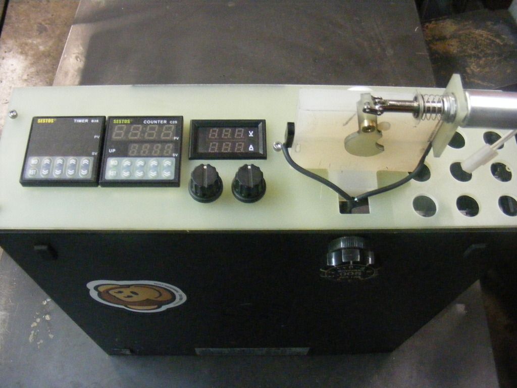

Happy as guys got my sensor working and its how i wanted it so a very happy xmas to me
Merry xmas guys and thank you for all your hard work to make mine easier.
will make a small vid later to show it off, but very stoked :)
WOW..... Looks nice. Nicely put together. I know you still have the auto-feed to get going, I'm sure that will be something else. I see the 48VDC PS is 750 watts. I'm sure you will find your case placement for the best transfer of power. BTW what caliber will you be annealing most of the time? With that high current I'm sure your anneal time will be short. With high current your inductor PCB may get really hot, the capacitors, that is. Also with auto-feed you may have a short duty cycle between annealing, for cooling of the PCB.
All new territory....
Great job..
Gina
This PS has externally adjustable voltage and current limiter (knobs on front) thus the need for a 5v supply from a LVR. Doing 221FB to 300WM with lots of 223 based and 6BR. Note black knob on bottom, this is the height adjustment, screw jacks the baseplate up and down within the T-slot cut in the front plate. Front plate is a piece of 3mm green Garolite (think 'paper'glass) I had laying around.
Induction PCB has heatsinks glued on the bottom of the board. Fan is shrouded and blows right at 'er.
Went with a 'tennis racket' style trapdoor instead of a direct slide, figured it would be easier with the optical sensor location, plus the spring pre-tension, stroke and leverage are easily set up, those things don't pull worth a darned and are slow when the rod is almost out of the solenoid. Small chain link allows for bind free operation as it swings thru its arc. Brass shoulder screw on pivot and the nylon screw right next to it is the closed position stop.
Oh and the best part- Holley carburetor float soldered to the radiator as the radiator expansion tank, with coolant level sight tube and vent. :D
