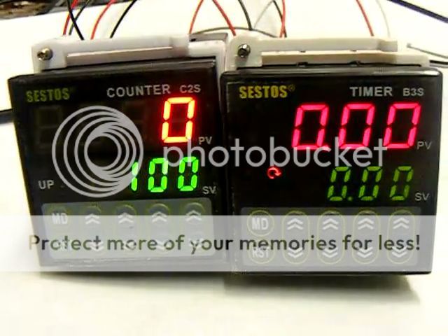

I got the timer and counter in and had a chance to play with them, counter works as both a total count if set point is 0, or you can have it hold a stop signal to the timer and shut it off after the count set point is reached. No signal inversion needed, counter can be set to trigger high or low.
I chose DC powered, relay output versions.
Now to test the optical proximity sensor and if it will work in a drop tube situation. It is a self-contained unit with 3 wires- 5v, open collector output, and 0v. 5v supply is going to be a small sub 1A linear regulator rather than a separate power supply. Will have to breadboard test things first. These units are cheap at 6 bucks, sight distance is 1/2". Only question is whether a case in a drop tube will transmit a signal for the over 100mS duration needed for the timer to recognize a start or stop signal. Its really close to 0.1 seconds for a 45mm long object time to fall the first few inches of the tube.
Why not add a 555 timer in a one shot configuration? The case would trip the timer (555) and the output pulse can be set for as long as you want.
