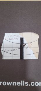

I had a Ruger No. 1 built, chambered in 22 Creedmoor and we (Gunsmith, Barrel Manufacture and myself) built it around a Hornady 62-grain ELD-VT and decided on a 9 twist with a 26-inch barrel for long-range varminting. A couple days ago I watched a video of an ELD-VT vs V-Max and what the difference behind the designs were. I questioned the twist rate and decided to email Hornady. Hornady said a 9 twist will not stabilize the mention bullet. See video below.
I think Hornady is wrong.

So how/why would it shoot a heavier 80-grain ELD shown in picture so well? That group reflects the 3rd, 4th and 5th shot out of that gun. The first two were sighters. I guess we'll just have to wait till load development starts!
I just ran it again with an 80eld and it’s .98. That’s at 2950 but these are velocities I get from my rifle. Velocity has an effect on stability as does temperature and elevation but nothing is as significant as barrel twist. My gun is a 223AI but the velocity numbers are true to my gun. The 22 creed may go faster but like I say it’s not as significant. You should download the Hornady ballistic app. Nonetheless you have a 9 twist barrel and you’ll need to test loads to see. I had a 9 twist before I had the 8 and 7’s. The 73eld and Barnes 69 match burners shot great in my 9 twist. You need to buy 100 of the 62eldvt to test in your gun. 1.2 is theoretically less favorable than 1.5 but I shot 1.2’s and had good results before I got faster twist barrels. There’s another twist rate calculator that works for ballistic tip bullets like the ELD’s but Hornady’s 4DOF calculator doesn’t align with it. On a different note, Hornady also designed a cartridge/chamber the 22ARC with a free bore so long that it’s designed for AR15 using their secant ogive bullets that have to jump significantly in the chamber and I’ve yet to find any of their secant ogive bullets that shoot well more than 0.007 from the lands. At these seating depths the ammunition won’t fit into the magazine. Mag length cartridges don’t shoot good groups for me so thanks Hornady.
