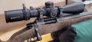

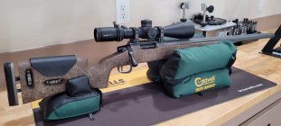

It was my first rifle when introduced to the rat scene. It keeps crossing my mind as an essential for the rat arsenal. But I never like the tapered case, I would have chambering problems from time to time. When I got back into the scene, I wanted a big boy 22 CF. I considered the 22-250, 22-250AI, the 22 Creedmoor. All three are barrel burners, one you have to fireform brass and the other one seemed to be the more logical choice. By the time I got something half accurate to fireform, then fireform 1000 pieces of brass, it would be time to rebarrel the AI. However, I sometimes think I went overboard bringing on a CM for rats. So, I have since decided to designate the CM for LR rock chucks, and simply to another build. The other caliber is a must and is a primary choice for me in the rat patch is the 223 as Rick mentioned. I built one around the Hornady 40 grain Vmax on a Terminus Apollo (Single Shot), Benchmark 26-inch HB and 14T.
