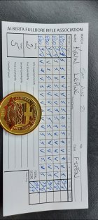

I just found this thread and fiinished reading it. While I’m not shooting groups, I do shoot steel plate matches from 550-1100 yds Prone off a bipod.
I had built a 300 SAUM for long range because the one I had was just a hunting rifle and it had shot exceptionally well and figured it would also at long range with a different barrel. I‘m shooting 200.20X bullets with BR2 primers, 58gr Reloader 17 at 2830fps out of a 26” barrel.
after reading this I will be trying H4350 and Reloader 23 and was thinking I’d try the 208 Hybrids once components become more accessible.
This was one of those targets as it was from the factory. 3 shots 190 VLD Berger.
