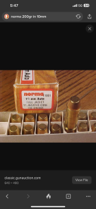

I would like to get to the Norma original load of 1200 FPS with Blue Dot any suggestions?
i think you have a basic error, original 10mm was not a 200
other than that blue dot is just a pain to weigh/load
The 10mm Auto from Orginal loadings were 170gr and 200gr
Yes BD big flakes like 800x can be a pain but I use a RCBS 1500 Chargemaster he doesn’t mind !
