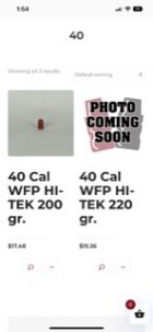

Love this Straight Shooter bullet 220gr Hi Tek coated 220gr hard Cast 22 BHN and it’s cheap too. Great for Alaska Bush !

9.5 BD with this 220gr bullet
Shoots great and 22BHN hard
Coal 1.243
CCI 300 and Starline brass
